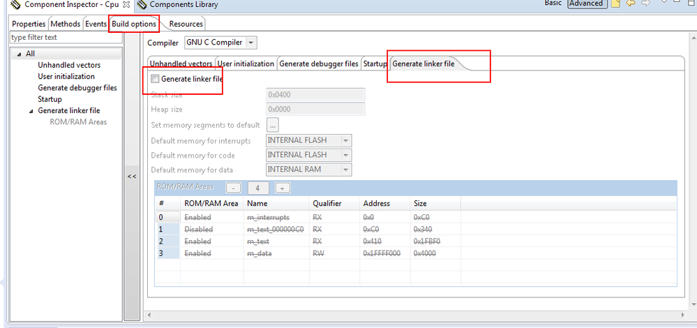

Hello Rutvij,
Please see the attachment , it is i create on on KDS3.0 - PE project about FRDM-KL25 board, the function is set the green LED.
the "kl25_led_test.bin" is the file which can use the KBOOT to update .  Please check the project and file on your side.
And i think you may ignore  disable " Generate linker file" , if you have not done this , when you build , the linker file will restore to default.
Hope it helps
Alice
