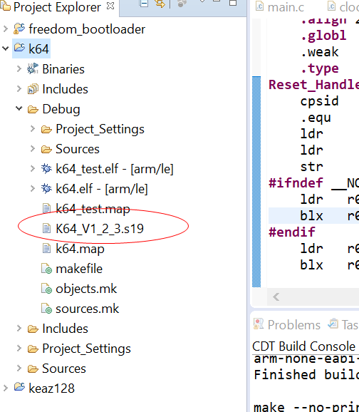

Hello Robert,
Sorry I don't really know your meaning , do you want to rename file with version number ?
If yes, how about the post-build commend:
- Add Build Variable"Newname":
- In Post-build, input command:
- Build , the new name with version number appeares:
