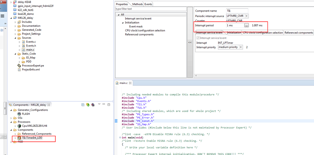

Hello Ken,
David's suggestion is good .
Also you can create PE project on KDS, then add the component of  "TimerInt_ldd",configuration the  Interrupt period to 1ms,
void delayms(int t)
    EventCount = 0;
    while(t > EventCount);
In the timer interrupt function :
void TU2_OnCounterRestart(LDD_TUserData *UserDataPtr)
  /* Write your code here ... */
    EventCount++;                                      /* Increment counter of events */
We can use the delay function :
void main ()
  delayms(20*1000);  // delay 20s
Hope it helps
Alice
