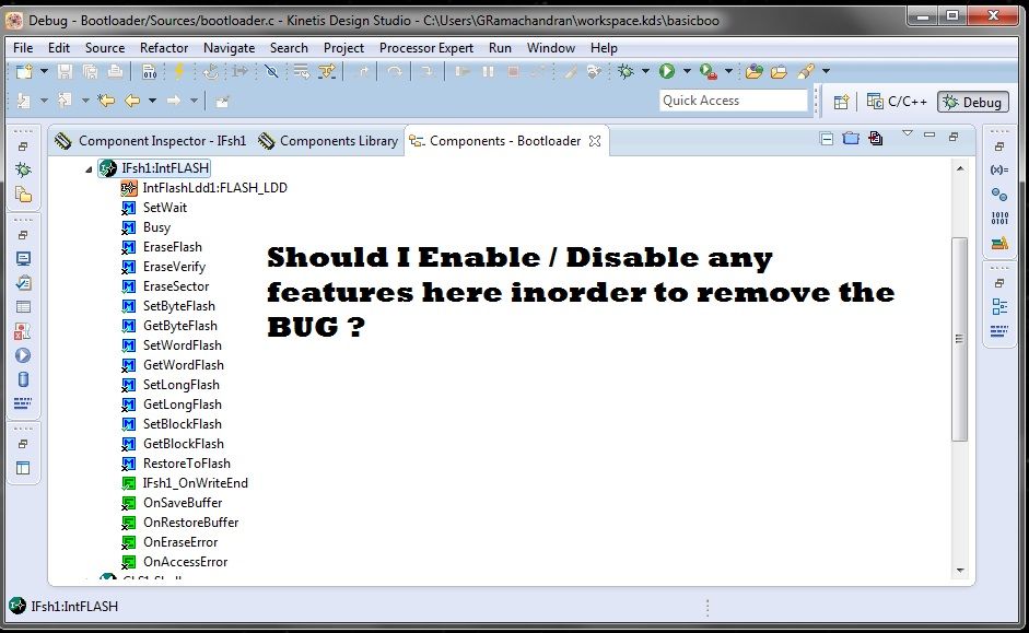

When I "Build" the code, I got following errors.

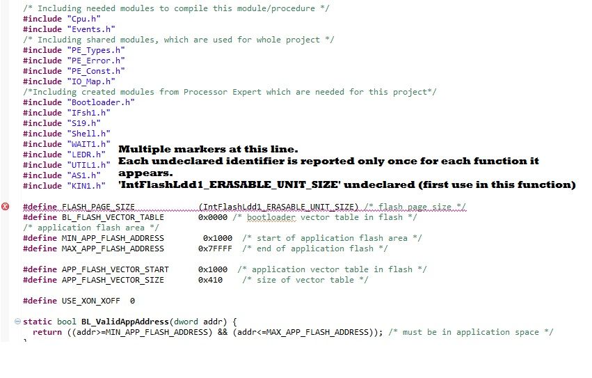

1. Error in the Flash Declaration
           IT SAYS THAT THE IntFlashLdd1_ERASABLE_UNIT_SIZE IS UNDECLARED
     IN ORDER TO FIX THE ERROR SHOULD I ENABLE OR DISABLE ANY FEATURES INSIDE THE FLASH COMPONENT ?

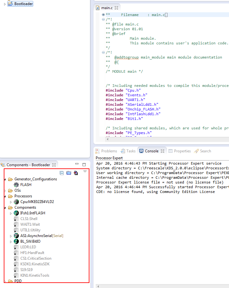

(if the pic is not clear) As of now the Enabled features are,
  1. IntFlashLdd1:FLASH_LDD
  2. EraseSector
  3. SetByteFlash
  4. GetByteFlash
  5. SetWordFlash
  6. SetBlockFlash
  7. IFsh1_OnWriteEnd
1.How to fix this Error pertaining to Flash Declaration ??

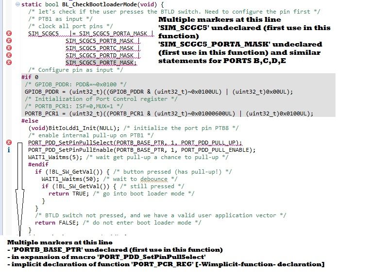

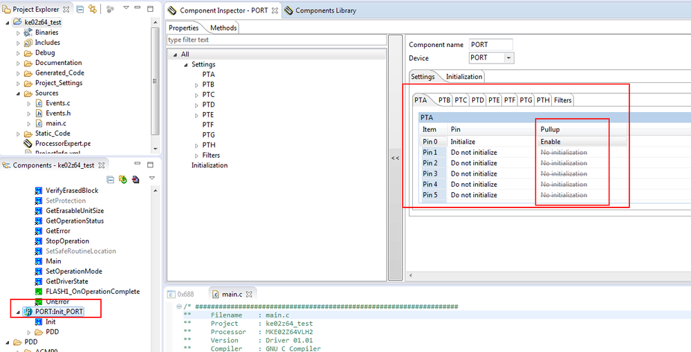

2. Errors in Clocking and Enabling Pull Up
                              SAME UNDECLARED ERRORS HERE TOO
SIM_SCGC5.... SYNTAX  does not support KINETIS E CONTROLLERS I guess. So I asked in this same forum and got this reply.
Clocking Port Pins in KE-02Z Controllers
2.a. From the answer, if clocking is done automatically after reset, then can I simply delete that code and start over with
/*Configure Pin as Input */
2.b. The next problem is with enabling the Pull Up. I guess there should be different syntax for Kinetis E series Controller.

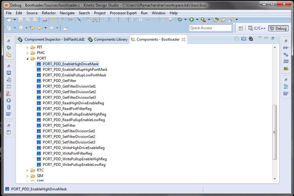

These are the Components inside my PDD --> Port, in my Processor Expert.
So to fix those errors in 2 statements pertaining to Pull up, which 2 statements are to be selected ?
PORT_PDD_SetPinPullSelect(PORTB_BASE_PTR, 1, PORT_PDD_PULL_UP);
PORT_PDD_SetPinPullEnable(PORTB_BASE_PTR, 1, PORT_PDD_PULL_ENABLE);
What are the alternative statements fixing my problem ?

Hello Ganesh,
1. You only can use the functions the components for your chip have :
If you copy the code from other chips , you should be sure for your chip , it also have the define .
2. For the GPIO , yes , you can directly configure the GPIO without enable the port clock .
3.About the pullup, you can configure it at the "Init_PORT"component to configure it :
If still have any question , you can send your project to me .
Hope it helps
Alice

Thanks alot for sharing those projects :smileyhappy:  . But still if possible can you just fix or guide me a possible replacement for this code snippet.
#include "BL_SW.h"
#include "PORT_PDD.h"
static bool BL_CheckBootloaderMode(void) {
  /* let's check if the user presses the BTLD switch. Need to configure the pin first */
  /* PTB1 as input */
  /* clock all port pins */
  SIM_SCGC5   |= SIM_SCGC5_PORTA_MASK |
              SIM_SCGC5_PORTB_MASK |
              SIM_SCGC5_PORTC_MASK |
              SIM_SCGC5_PORTD_MASK |
              SIM_SCGC5_PORTE_MASK;
  /* Configure pin as input */
#if 0
/* GPIOB_PDDR: PDD&=~0x0100 */
GPIOB_PDDR = (uint32_t)((GPIOB_PDDR & (uint32_t)~0x0100UL) | (uint32_t)0x00UL);
/* Initialization of Port Control register */
/* PORTB_PCR1: ISF=0,MUX=1 */
PORTB_PCR1 = (uint32_t)((PORTB_PCR1 & (uint32_t)~0x01000600UL) | (uint32_t)0x0100UL);
#else
  (void)BitIoLdd1_Init(NULL); /* initialize the port pin PTB8 */
  /* enable internal pull-up on PTB1 */
  WAIT1_Waitms(5); /* wait get pull-up a chance to pull-up */
  #endif
    if (!BL_SW_GetVal()) { /* button pressed (has pull-up!) */
      WAIT1_Waitms(50); /* wait to debounce */
      if (!BL_SW_GetVal()) { /* still pressed */
        return TRUE; /* go into boot loader mode */
    /* BTLD switch not pressed, and we have a valid user application vector */
    return FALSE; /* do not enter boot loader mode */
What the above code has to do is to Clock all the port pins, Configure Port B pin 1 (PTB1) as input, initialize the port pin PTB1, enable internal pull-up on PTB1, rest are common Wait statements.
You said, In KE-02 controllers, clocking is done by default after reset. But am clueless as to how to write the code for other operations mentioned above.  Can you provide me a code snippet which replaces the above but supports KE-02Z controllers.

Hello Ganesh,
Your cod is clearly not for the kentis E series . So i recommend you refer to one simle
KE series project code .

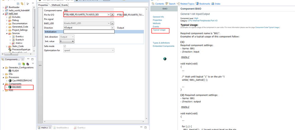

For example , for the PTB1 you said , you can create one simple PE project on KDS:
then add "GPIO_LDD" component , configure it , and refer to the "typical usage" to test :
I chacked you use the BITIO component,  ok, this is the same ,you can also refer the typical usage :
Please give up these code you show , they will confused you .
Alice

MarekTrmac
Hi Ganesh,

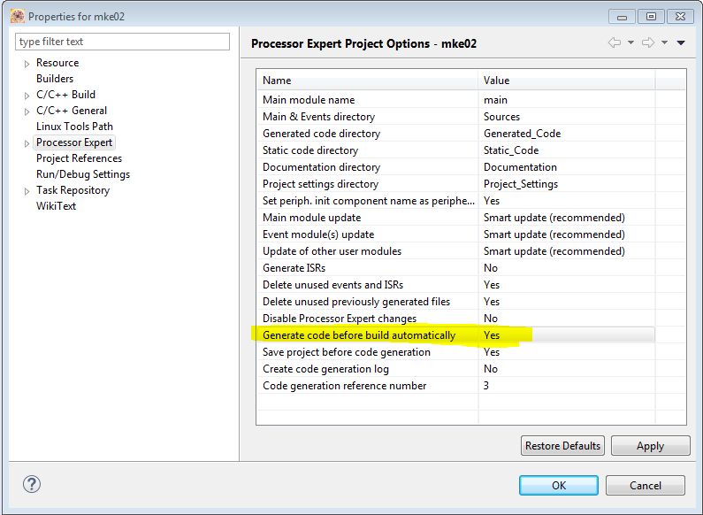

please ensure, you have set in your project option to generate code before the build. Use project - properties and see attached picture, the option shall be on by default. You can also generate code from Components view - see command "Generate Code". I tried to reproduce the problem with Flash in KDS 3.2 and I did not reproduce it.
About the supported registers, please refer to header file located in "Static_Code\IO_Map\MK02Z2.h" in your project (after code generation). The header file contains declarations how to access registers and thier bitfields.
Marek
