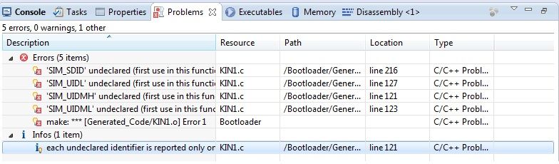

I am working on MKE02Z64VLD2 in KDS 2.0.

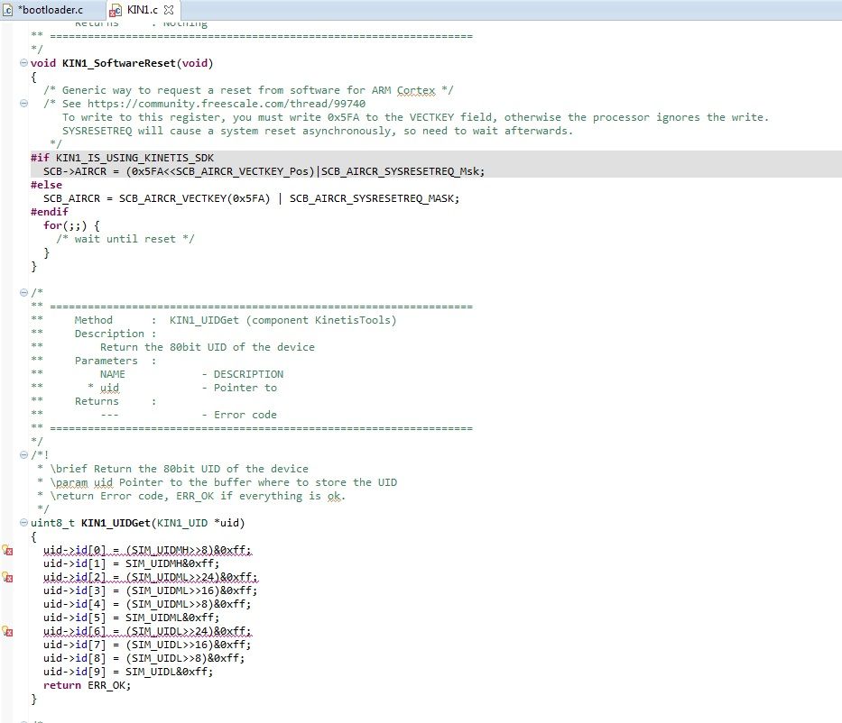

The above code block is an excerpt from my main Project code. I wanted to include software reset in my code. So I included KINETIS TOOLS PE Component into my Project.
BUT When I build the code, it threw errors in Kin.c
Then in Kin.c I found KE-02Z to be missing
#if KIN1_CPU_IS_M0_PLUS static const unsigned char *KinetisM0FamilyStrings[] = { /* FAMID (3 bits) are used as index */   (const unsigned char *)"KL0x",          /* 000 */   (const unsigned char *)"KL1x",          /* 001 */   (const unsigned char *)"KL2x",          /* 010 */   (const unsigned char *)"KL3x",          /* 011 */   (const unsigned char *)"KL4x",          /* 100 */   (const unsigned char *)"Reserved",      /* 101 */   (const unsigned char *)"Reserved",      /* 110 */   (const unsigned char *)"Reserved"       /* 111 */ }; #endif

Please use the latest McuOnEclipse components from SourceForge (McuOnEclipse - Browse /PEx Components at SourceForge.net ), as KE02Z support has been added to the KinetisTools component in the 04-April-2016 release:
uint8_t KIN1_UIDGet(KIN1_UID *uid)
#ifdef SIM_UIDMH /* 80 bit UUID: SIM_UIDMH, SIM_UIDML and SIM_UIDL */
  uid->id[0] = (SIM_UIDMH>>8)&0xff;
  uid->id[1] = SIM_UIDMH&0xff;
  uid->id[2] = (SIM_UIDML>>24)&0xff;
  uid->id[3] = (SIM_UIDML>>16)&0xff;
  uid->id[4] = (SIM_UIDML>>8)&0xff;
  uid->id[5] = SIM_UIDML&0xff;
  uid->id[6] = (SIM_UIDL>>24)&0xff;
  uid->id[7] = (SIM_UIDL>>16)&0xff;
  uid->id[8] = (SIM_UIDL>>8)&0xff;
  uid->id[9] = SIM_UIDL&0xff;
#else /* some devices like the KE02Z only have 64bit UUID: only SIM_UUIDH and SIM_UUIDL */
  uid->id[0] = 0;
  uid->id[1] = 0;
  uid->id[2] = (SIM_UUIDH>>24)&0xff;
  uid->id[3] = (SIM_UUIDH>>16)&0xff;
  uid->id[4] = (SIM_UUIDH>>8)&0xff;
  uid->id[5] = SIM_UUIDH&0xff;
  uid->id[6] = (SIM_UUIDL>>24)&0xff;
  uid->id[7] = (SIM_UUIDL>>16)&0xff;
  uid->id[8] = (SIM_UUIDL>>8)&0xff;
  uid->id[9] = SIM_UUIDL&0xff;
#endif
  return ERR_OK;
KE06 support will be added for the next release.

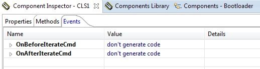

Dear Erich,
Thanks a lot for helping me out. Now I face another problem after installing the new update. Some error is throwing from SHELL, which never showed before.
The Processor Expert code is not getting generated.

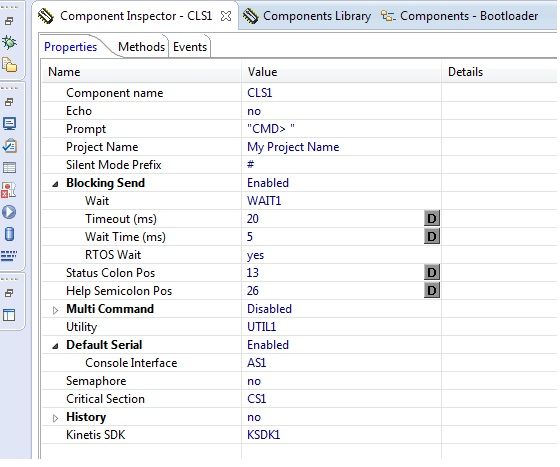

It Says PROPERTY NOT FOUND " KinetisSDK "
This is How My Shell Component looks inside
How to fix this error ? :smileysad:

my bad :-(. That fix is availble on GitHub, but not released yet. Can you use the attached updated Shell component?
