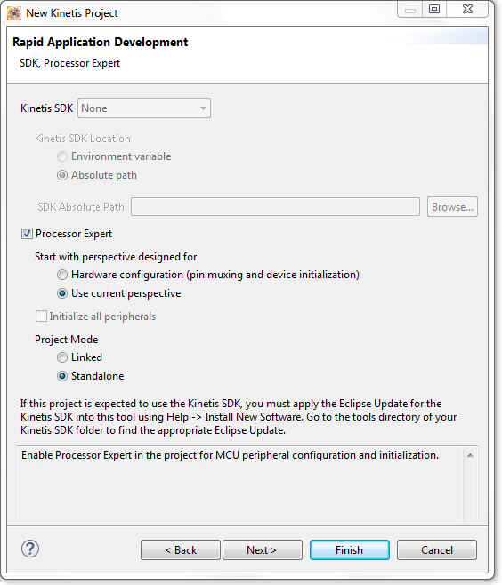

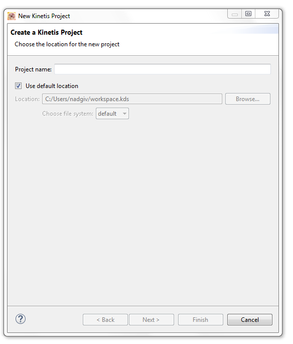

Hello Reddy,
  1. Click on New Kinetis Project
  1. Enter Project Name
  2. Click Next, Select processor
  3. Click Next, Enable Processor Expert
  1. Click Next, Select Compiler
  2. Finish
  3. Write your code, Build it
  4. Click on debug icon
Create de-bug configuration
Click on debug
Run it
