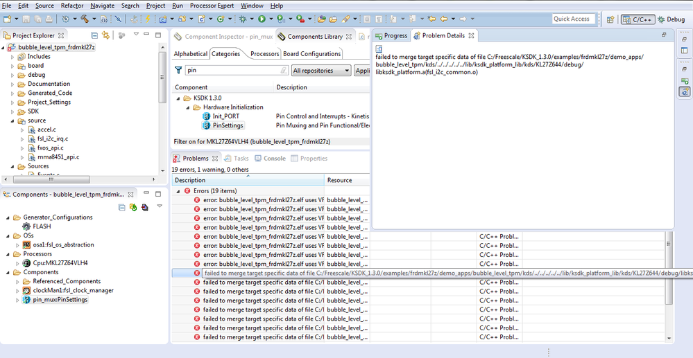

Hello everyone.
First of all, I tried to follow steps on this link:
Adding Processor Expert to C Project (with SDK in PEx Driver Suite)
And also follow the Help Contents on Kinetis Design Studio in "Adding Processor Expert Project to an Existing Project".
I was trying to add Processor Expert to the bubble_level_tpm example project from FRDM-KL27Z folder.

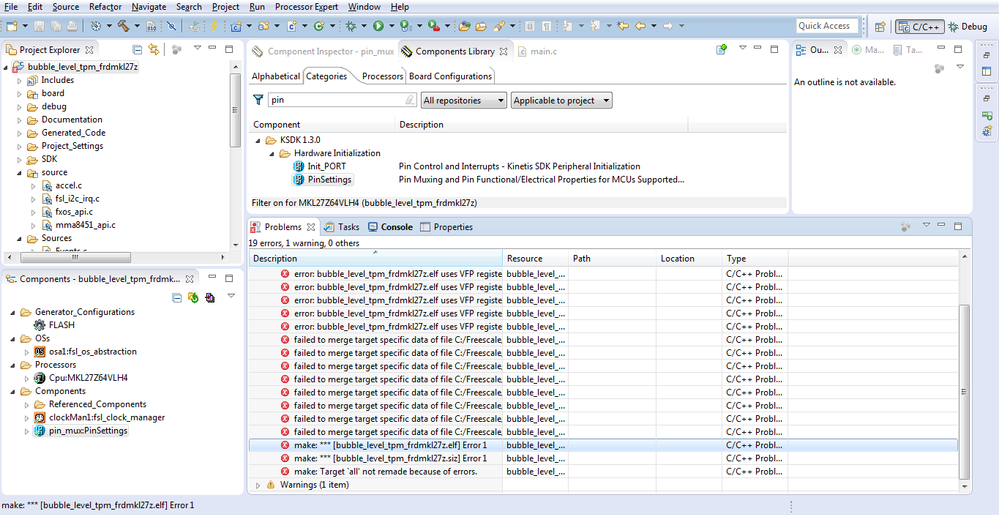

Everything worked fine until the build time.I did all the steps as it should be done, but in the end I got some erros. The errors are in the images below.
I posted my entire project and the Console window on Google Drive, in the links below:
bubble_level_tpm.zip - Google Drive
console.txt - Google Drive
I'm using KDS 3.0.0, KSDK 1.3.0 and Windows 7.
My platform is the FRDM-KL27Z.
What can I do to fix it?
Thanks for any help!

Hello Nícolas Ludwig ,
Please first build KSDK platform library in KDS IDE.
About the detail steps you can refer to :
"Getting Started with Kinetis SDK (KSDK) v.1.3.pdf"  -> 5.3 Build the platform library
Hope it helps

nícolasludwig
Hi Alice_Yang‌.
I did it, and I also put the necessaire paths in settings of my project, and then the errors appears.
Thanks and I await.

Hello ,
 - I  test on my side , after fixed this error , there will be others.
It needs much time , we might as well create a proejct based on PE, then copy the application code into it.
also your proejct just a simple demo code , it is more easy than adding PE to project.
- And the Guide you mentioned just a general guide , there will be defferent build error for defferent project.
- The KSDK1.x is old , If you just started development , I recommend you use the latest version KSDKv2.x.
