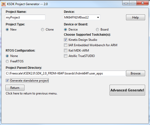

- After you open the KSDK Project Generator , click "Advanced" :
- Then configure this view refer to your requirement :
- The project have been generated ,it under the Project Parent Directory you configured :

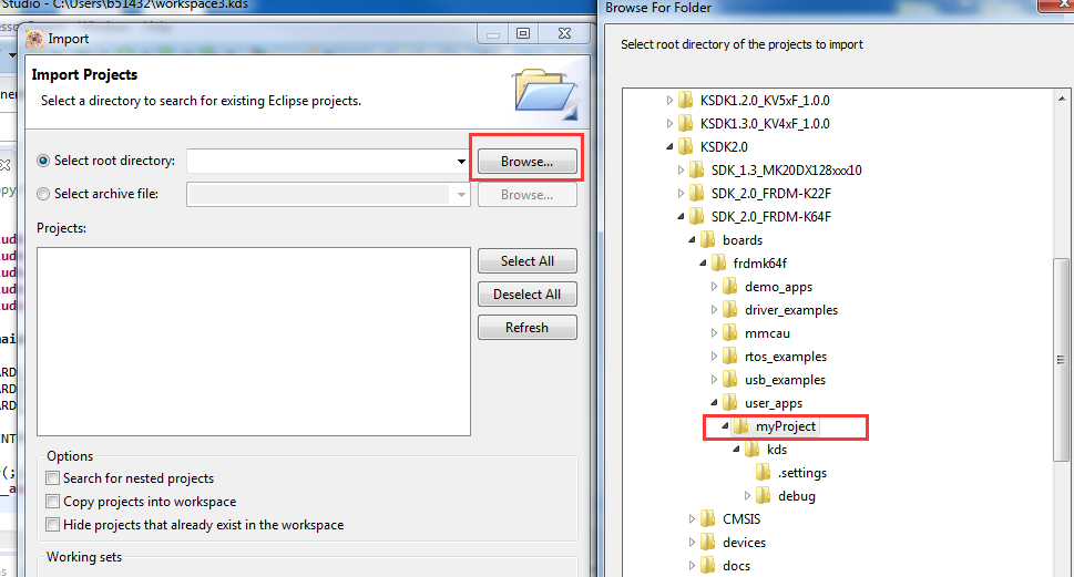

- If you want open it on KDS, please open KDS, then  click Import :
- Select the project you create :

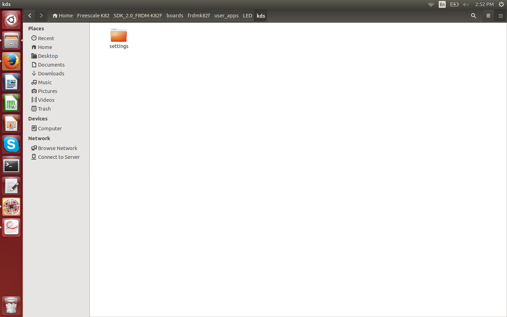

I did the same as you suggested but still I am not getting any .wsd file under kds directory.

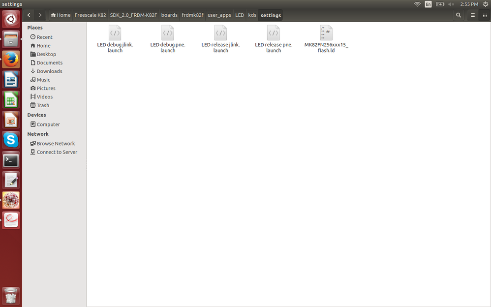

Its creating a single folder with name settings under kds directory whose contents are as shown in screenshotkds.png
Also I am working with Ubuntu 14.04 as a Host.
Kindly give your suggestions to solve this issue.

.wsd file is not needed. To import project you need only .cproject and .project files. Use File - Import to import the project (see screenshots above).

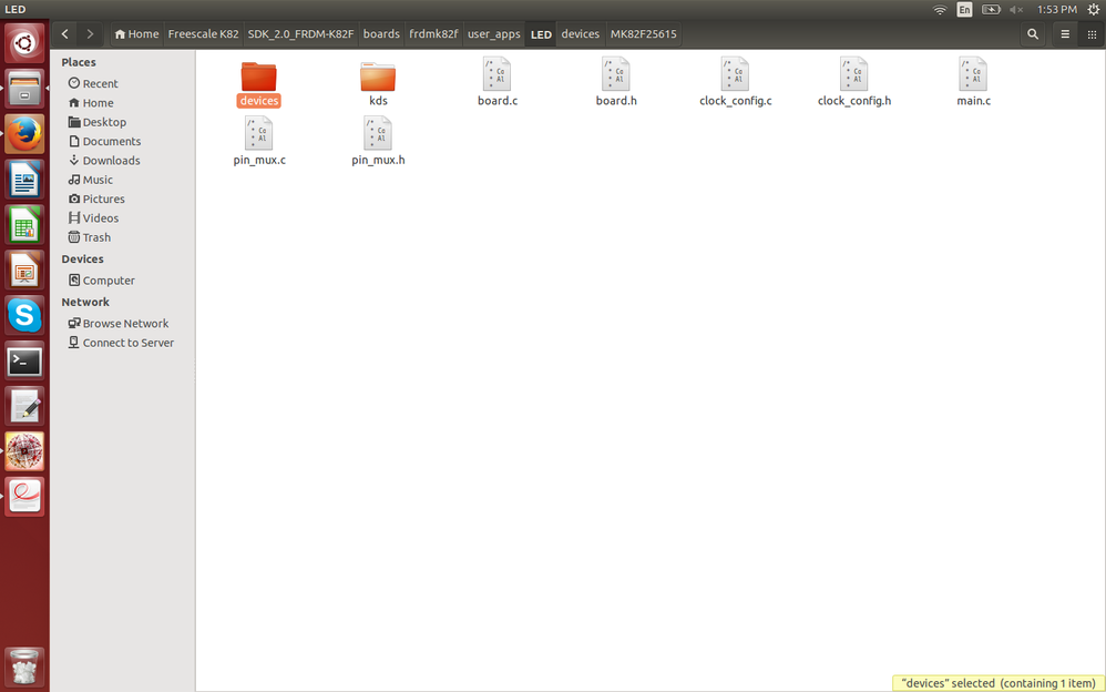

The below screenshot shows the directory structure created by project generator.
Now, tell me which file I should import ?

And please show the files and folders under .../LED/KDS of your project path .
ALice

For the existing demo applications *.wsd file is present under kds directory
The Files  under KDS directory are as below:
The files under settings directory are as below:
3,938 Views
