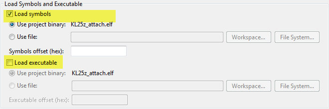

BlackNight
Hi Leif,
you can specify that it shall load only the symbols, but not flash the application file:
However, the Segger GDB still does a reset of the target at connection time: so it is not a true connect/attach, as the device receives a reset.
I hope this helps,
Erich

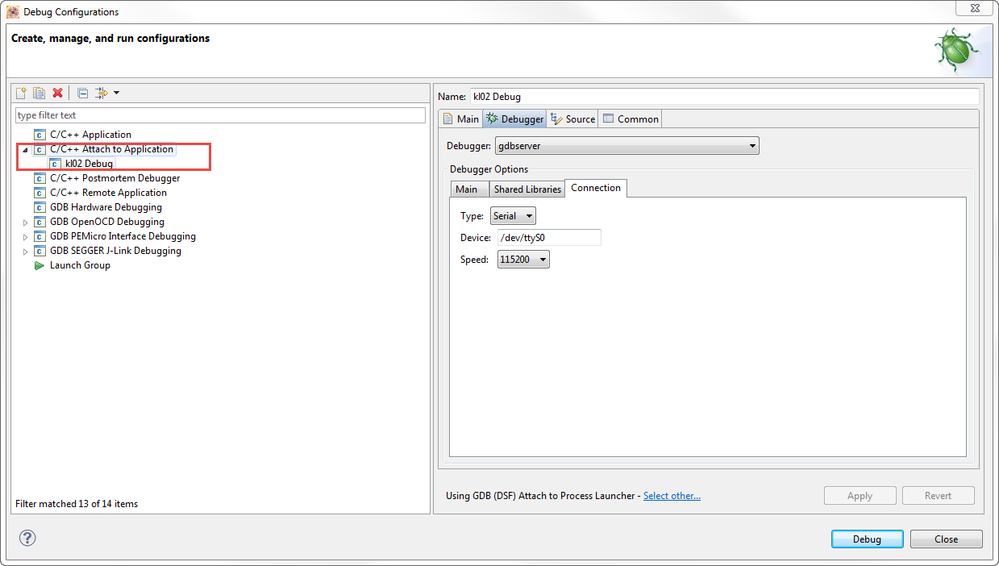

leifzars
No I mean attach to an running device, not re downloading and then attaching as you normally do when you start a debugging session.
CW has the option to Download, Connect, Attach and Custom when starting a debugging session.
4,067 Views
ZhangJennie
Hi Leif,
from my understanding, KDS doesn't have exact feature as CW,
CW uses a proprietary debugger engine while KDS uses gdb, that's different.
with KDS, we can use C/C++ Attach to Application feature:
Zhang Jun
