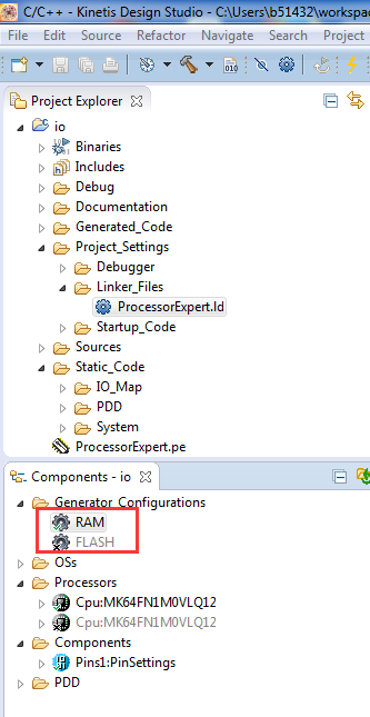

I search in the community and in Eclipse under KDS 3.2.0 and documentation, and i find nothing about how to run code from FLASH.
By default KDS run code from RAM and i need to know the reason to run code from RAM instead of FLASH.
I understand  that it is usefull to RUN in RAM in Debug mode to place debug tag in code without wearing the FLASH, but i don't understand why running from RAM when we are in Release mode  ?
And even in Debug and Release mode It seem to me mandatory to run code from FLASH, because we have near always much more FLASH than RAM.
In all case is somebody know  where
In my case and for many application it is very important to use only RAM for data and running code from FLASH,
With CodeWarrior the choice is very easy and visible but in KDS  nothing ?

Hello JEANJEAN,
If your project with processor expert on KDS, you can directly chose "RAM" OR "FLASH" :
If not , i think you can refer to the linker file which PE project generate to configure.
Hope it helps

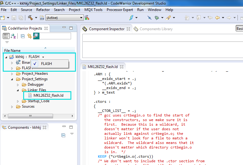

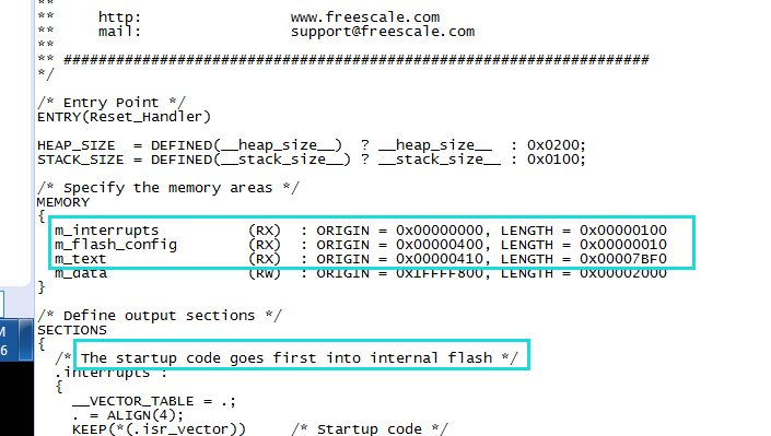

Hello Muniraj,
- For the MKL17 chip only has 8KB SRAM, it is so small , so we do not save
the code to SRAM.
On CW, for the kineits L series that have small SRAM, there is not the selection for "RAM",
 there is only "FLASH" , for example the chip of MKL26 :
-  And i checked your question again, do you want to start from FLASH ?
If yes, the project on KDSv3.2 is just start from flash :
Hope it helps

Muniraj, for the reset issue you have, i can say to you that i use K22F and this microcontroler start with no problem in debug with OpenSDA probe and release with no OpenSda probe and i connect  /RST to 4.7K to Vcc and 100nF to Ground .
For the question about the FLASH , i must say that i use JKDS 3.2.0 and SDK 2.0 that exclude the use of Processor Expert, this is actually a limitation of KDS. And in that case i found nothing even in the linker parameter to run from FLASH.
Muniraj, yes the startup code start in FLASH memory and there is no choice for startup, but after it load all FLASH code in RAM and run from RAM. You can verify this in the console  where "dec" is the total Byte in RAM, ("dec"=98792 can't go over 128K with  K22F evant if i have 512K of FLASH and this seem a bit nosense for me)

Hello Didier,
About the place of  "text  data bess ", you can refer to this DOC :
https://mcuoneclipse.com/2013/04/14/text-data-and-bss-code-and-data-size-explained/
Alice
