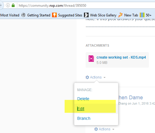

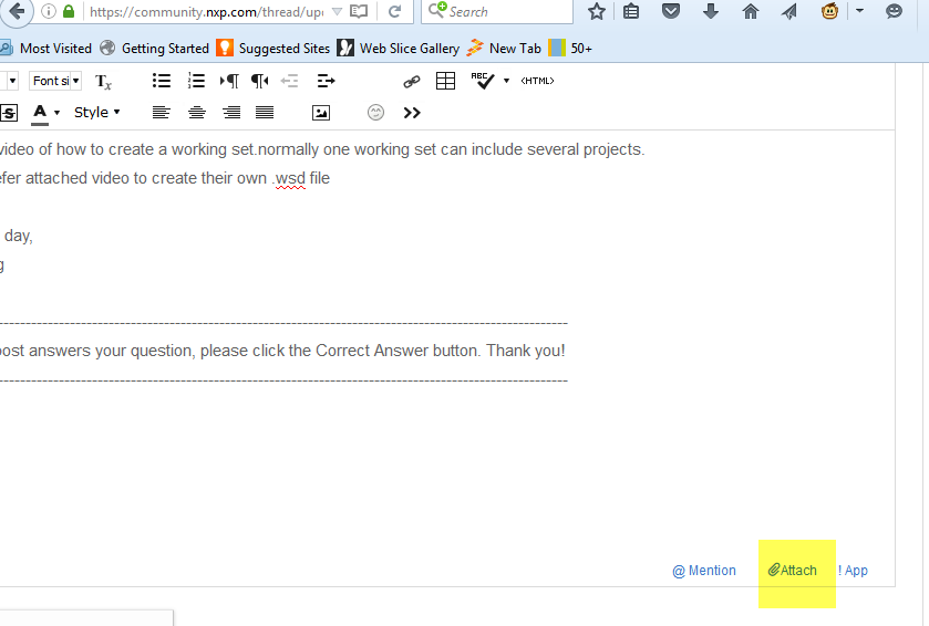

How do I send zipped project files to this forum?
7,447 Views
ZhangJennie
click on Edit:
then "Attach"

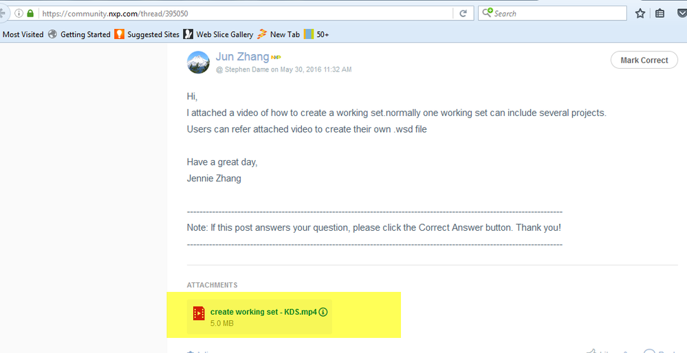

aerodame
No, I see your image but not the video.
7,447 Views
ZhangJennie
I send the video to you via transweb. Please check your emails with transweb accessing password.
I also send a copy to your email address
can you get the video now?

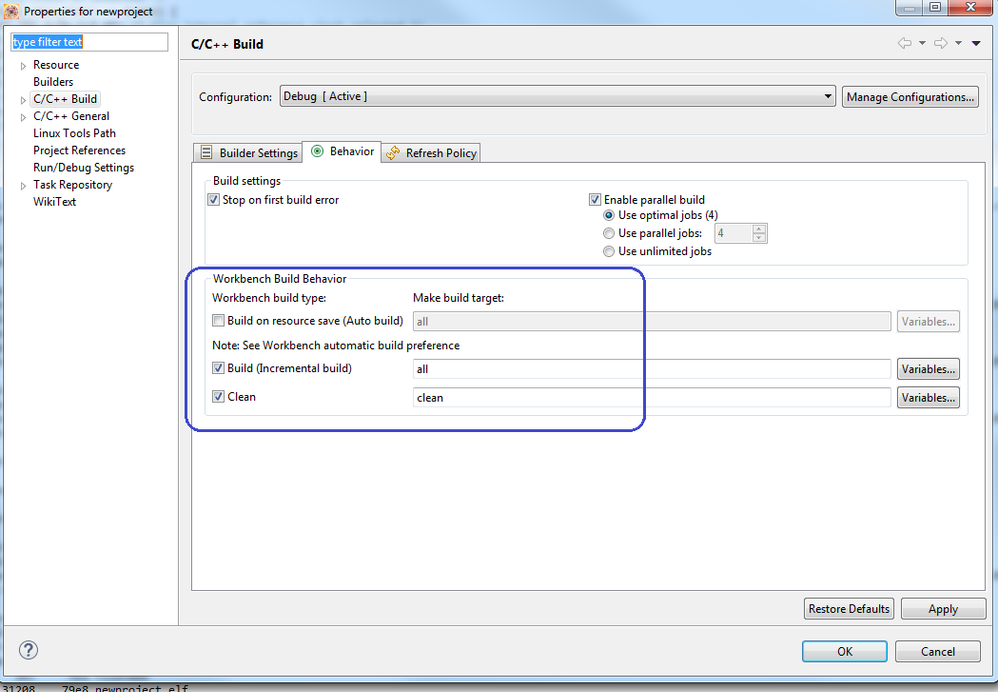

BlackNight
Hi Stephen,
make sure you have 'build automatically' disabled. See https://mcuoneclipse.com/2016/05/26/build-and-clean-selected-files-in-eclipse-cdt/ and the trouble shooting section.
I hope this helps,
Erich

aerodame
Good tips all...  I'm racing up on a holiday 4 day weekend.  I did make a little progress today by setting up both a Mac and Windows8 computer.  The Windows 8 computer doesn't seem to have the debug issue (I think...)  but I'm still investigating.
The tip for disabling the automatic build works so that now I can just compile one file.  This is what I need to try and figure out how to incorporate the DSP CMSIS files and get them compiled.   If I have a lot of errors I need to narrow down to which file is causing me grief.

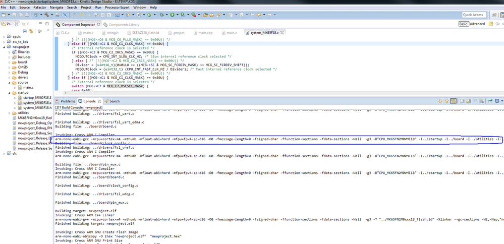

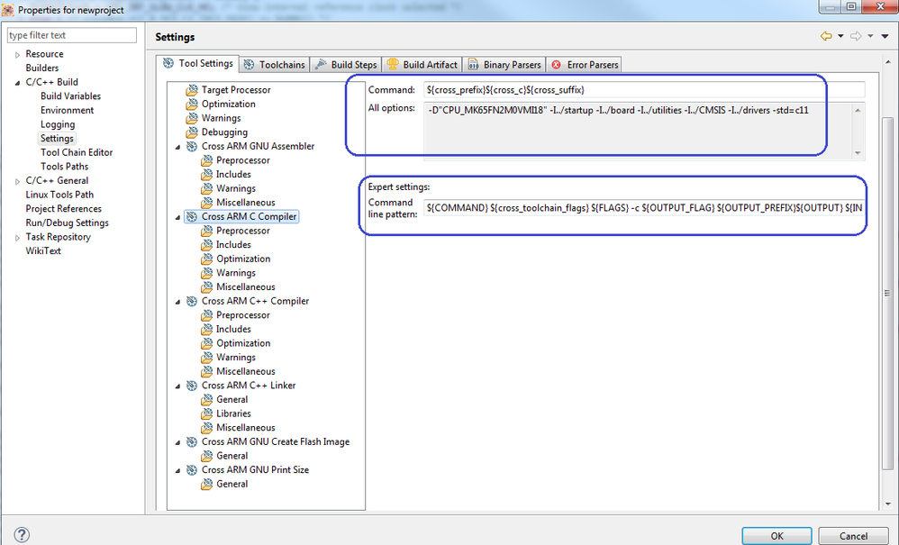

TICS_Fiona
Hello Stephen
To compile one signal source file, user can run the GNU Tools for ARM Embedded for compiling. The compiler tool is “arm-none-eabi-gcc.exe” which is under KDS installation folder:
C:\Freescale\KDS_v3\Toolchain\bin
The compiler command and options can be found from either Project Properties or the consol when building the project.
The KDS supports auto build, manual build, incremental build. May I know why you need to compile one single file? For its disassembly output?
