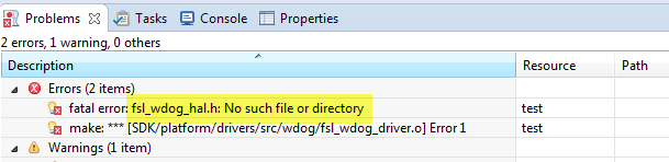

So I started to follow the getting started guide and build  a project using SDK 1.3.0 and not using expert processor however when the project is generated, I don't see the files needed for this simple project, Specifically under platform/drivers/source I see only one file which is rts.c so I decided to copy and paste from  sdk/platform/driver to my project ./test/platform .
However I keep getting  compile error :
In file included from ../SDK/platform/drivers/src/wdog/fsl_wdog_driver.c:31:0:
C:\Freescale\KSDK_1.3.0/platform/drivers/inc/fsl_wdog_driver.h:36:26: fatal error: fsl_wdog_hal.h: No such file or directory
#include "fsl_wdog_hal.h"
This file exists in my project under ./platform/drivers/inc  and also I see the path under the include tab of my project in the project explorer view of KDS.

I built your project on my side, I got error:
this is because the path for fsl_wdog_hal.h is not included in this project path setting.

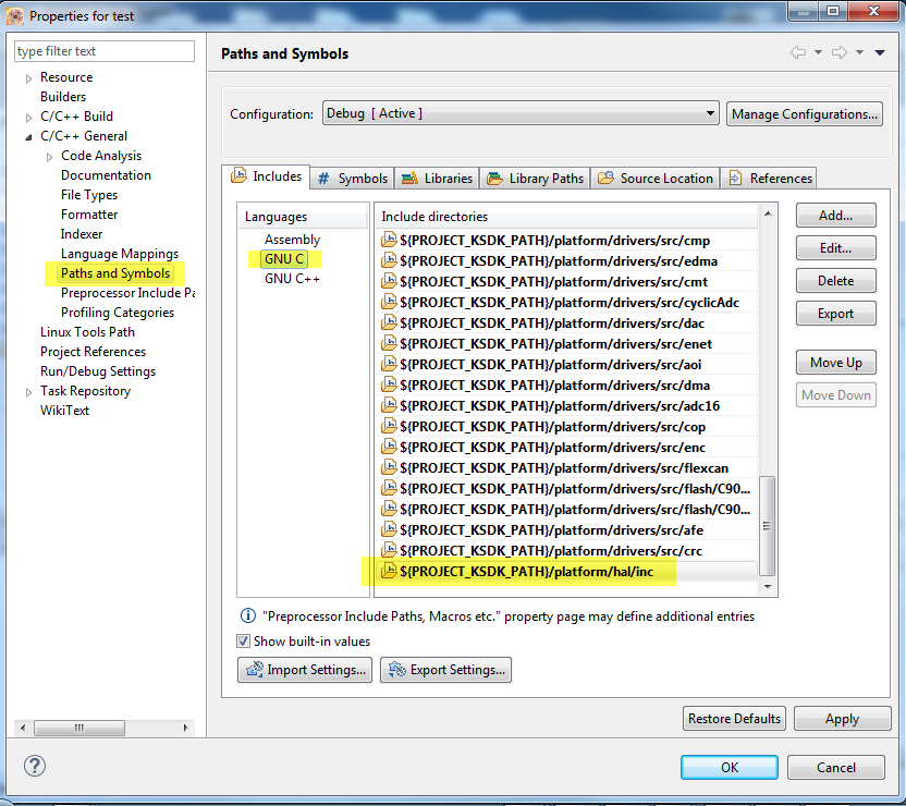

fsl_wdog_hal.h is under C:\Freescale\KSDK_1.3.0\platform\hal\inc
if I add ${PROJECT_KSDK_PATH}/platform/hal/inc to the project paths setting. this can solve the problem. see below:
you may have other similar path missing problem. please revise path setting with the same method.
