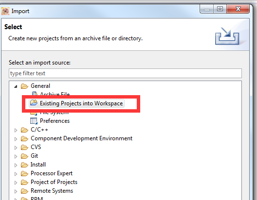

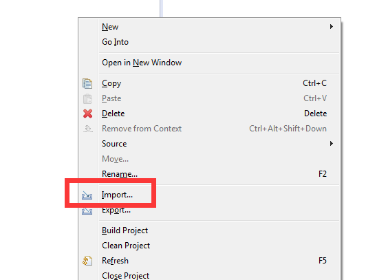

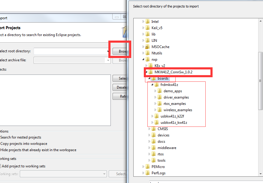

I recommend you use the latest version of "Kinetis Connectivity Software Version 1.0.2 ",
this is based on KSDKv2.0, so after download and install it , do not need build any lib , we can
directly import the demo as these steps :
select the demo you need :
Hope it helps
