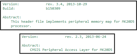

Hello Jan:
Sorry for the confusion created so far. There is no error or problem with the header files, you are just looking at two different kind of headers and the fact that the name is the same is just an inconvenience.
Please read my last response in the next thread: KL25Z CMSIS-Core/CMSIS Peripheral Access Layer headers
And the next discussion as well: why bare-metal head file is so different from PE head file even with same version like MK21F12.h
You can read the abstract for each type of MK20D5.h:
In KDS you may find both kind of files in these paths:
- C:\Freescale\KDS_3.0.0\eclipse\ProcessorExpert\Config\PE\CPE\wizard_data\wizards\kds\MK20D5\Include
- C:\Freescale\KDS_3.0.0\eclipse\ProcessorExpert\lib\Kinetis\iofiles
The No CMSIS compliant header is now only used when creating a project with Processor Expert using legacy LDD components (No KSDK).
There are macros not present in the CMSIS file, but you can easily replace such register accesses. In your case this would be the code:
PORTA->PCR[18]
PTC->PSOR

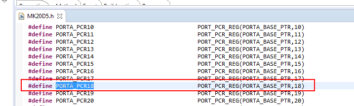

Hello Jan,
You are right .Some header files have not the define of "PORTA_PCR18" , it not your error , it have not been update .
While , i recommend you use the latest version of KDS3.0 , you can download it here :
https://freescale.flexnetoperations.com/control/frse/product?entitlementId=123588587&lineNum=1&authC...
For i checked it on my side , the version is :
Version:
rev. 3.4, 2013-10-29
And it have the define :
While my PC is windows , and if you have use the latest version in you pC  of MAC , it still have not the define , it meaning have not update .
it doesn't matter , you can copy and paste the define you use from CW .
Hope it helps
Alice

I just checked and the Linux version of KDS 3.0.0 also installs "rev. 2.3, 2013-06-24" of the MK20D5.h header file.
Steps to reproduce:
1. Install KDS 3.0.0 as described in documentation
2. Create a new project
3. Choose "Kinetis project" as a template
4. Enter project name
5. Choose MK20DX128xxx5 in "Processors"
6. Open the "Includes" directory in the project — there is no derivative.h and the MK20D5.h header is rev. 2.3.
