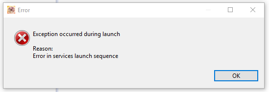

Hi all,
I was wondering if anyone happened to have any issues with connecting with the board itself. I am using a FRDM-KL25Z board and the most recent version of KDS. In addition I have already done all the software updates through the IDE. I am using a Windows 10 PC if that matters. All I have attempted to do so far is run a sample "Hello World" project that was included in the SDK package that I downloaded from the website. In order to run this project I followed the steps laid out in http://cache.nxp.com/files/soft_dev_tools/doc/support_info/KSDK13GSUG.pdf?fsrch=1&sr=1&pageNum=1. This is the "Getting Started with Kinetis SDK (KSDK) v.1.3 document. After following all of the steps very carefully, I get the following issues when trying to run the debugger.

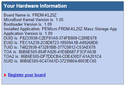

I have read that this may be an issue with out-dated firmware? I am not sure. Here is the information regarding what is currently on my board.
In addition, the power indicator LED flashes when it is plugged in rather than a solid color. Any help anyone could send my way to fix this issue would be greatly appreciated.

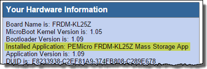

Hello Edward Franskevicz:
As shown in your information picture your board only has an MSD bootloader firmware (Mass Storage App):
What you need is either a Debug firmware or the combined MSD + Debug firmware.
Please carefully read all the next tutorial by colleague Erich Styger:
Illustrated Step-by-Step Instructions: Updating the Freescale Freedom Board Firmware | MCU on Eclips...
And about Windows 10, it indeed matters. You may need a Windows 7 machine to update the bootloader from version 1.09 to 1.11.
Best Regards!
Jorge Gonzalez

edwardfranskevi
Thank you very much Jorge. This did the trick. Extremely helpful.
