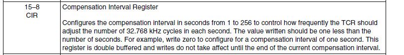

The CIR field, corresponds to the Period parameter of the SetCompensationPeriodAndValue method, in the picture above you can see the explanation.
In other words the CIR field will control how often the compensation value will be set, this means that if you want to compensate the RTC value every 4 seconds you need to write Period = 4. In the words of the reference manual: “The compensation interval is used to adjust the frequency at which the time compensation value is used, that is, from once a second to once every 256 seconds.”

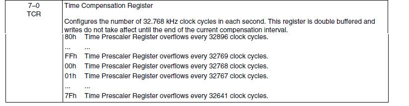

The TCR field, corresponds to the Value parameter of the SetCompensationPeriodAndValue method, in the picture above you can see the explanation.
In other words, this value will control how many clock cycles form the 32.768 KHz clock will be needed to overflow the Prescaler Register. Normally the value is 32768 clock cycles, this means that the Preescaler Register will overflow every 32768 clock cycles. With the Value parameter value you can control the number of clock cycles adding or subtracting clock cycles for a fine compensation. In the words of the Reference manual: “The time compensation value is used to adjust the number of clock cycles between -127 and +128. Cycles are added or subtracted from the prescaler register when the prescaler register equals 0x3FFF and then increments.”
