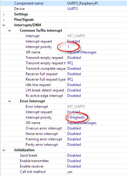

Now I have another project in KDS 3.2 that is very far along and has thrown the same type error:
Generator: FAILURE: Unexpected status of script: Drivers\Common\CommonRegInitialization.prg, please contact Freescale support.
Once again it is the CPU component that has caused the  error:
I tried all the steps suggested last time. I also inserted another copy of the CPU Component from the library, configured it the same as the one in error, and then deleted the bad one. But after a re-compile, the error returned immediately.

BlackNight
Hi Simon,
I checked your project and used it to track down where the problem is (took me some time and binary search to find out which component is causing that internal error (clearly a bug in Processor Expert).
alicewang‌ can you report to the engineering team?
The problem is caused in the Init_UART component, if different interrupt levels are used for TX/RX and Error interrupts as below:
If you assign the *same* priority for both settings, the problem goes away. I saw such a setting both for your RaspberryPi and XBee Uart.
I hope this helps,

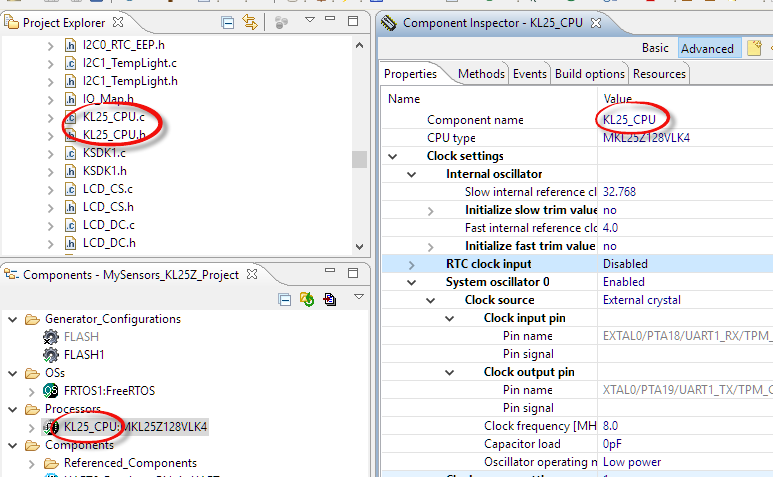

smachell
Hi Erich,
I fixed the 2 UARTs. Maybe they should redo that component so that when you change 1 IRQ like the TX/RX it would also change the other. In my case the ERROR IRQ setting was hidden below the page.
But I now have another issue which I mentioned earlier. It may be an artifact of fixing the UART? In the Generated Code section CPU.C and CPU.H have disappeared and everything I have tried will not bring them back. I have attached an updated ZIP.

BlackNight
Hi Simon,
because you have renamed the CPU component to KL25_CPU, the generated source files are KL25_CPU.c and KL25_CPU.h:
I hope this helps,
Erich

pablokuziw
Hi Alice,
I found where is the bug:
the error appears when I change interrupt priority in UART0 or UART1 from 0 (highest) to 1 (this option is available within Common Tx/Rx interrupt).
If I leave interrupt priority in 0 level, then there is no errors after build all.
Thank you for your time and I ask a new question: It´s a bug of KDS or it´s not possible to change interrupt level in this proccessor?
Pablo Kuziw
