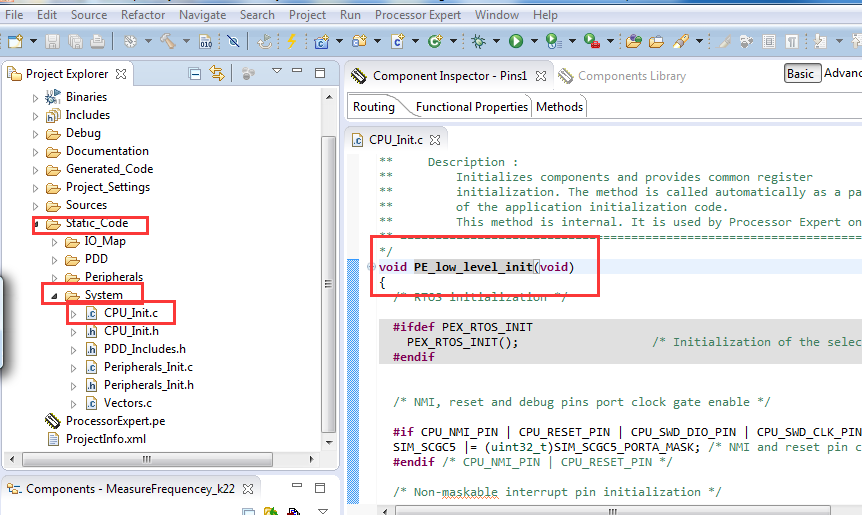

Hello I am trying to run the generated code for kl03z or kl17z on KDS using processor expert. That is sucessfully working and I get no error. However when I am trying to run it on IAR, I have to explicitly remove:"PE_low_level_init() in the main code! And then I can compile it sucessfully! However I don't really know if I am suppose to remove that since it says explicitly in the code that I should NOT do that ! Here is the code snippet :
/*** Processor Expert internal initialization. DON'T REMOVE THIS CODE!!! ***/
PE_low_level_init();
The error I get :
Error[Li005]: no definition for "PE_low_level_init" [referenced from C:\Users\volkan163\workspace.kds\ .
I have submitted a picture that shows the error I get.
How can I solve this problem ? I want to compile the generated code without errors .
regards,
VC

Additionally I can't find a "PE_low_level_init.c"  in the generated .c folders but I can see the .h file !

Hello Volkan,
In the generate code of KDS Processor Expert , the function of PE_low_level_init.c
is in the file of "CPU_Init.c" :
