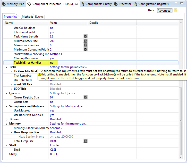

BlackNight
Yes, that setting came with v8.x.x. Actually it is a good setting as it will catch the case if you leave the task function. Otherwise it will jump into the wild.
But having that 'catch the exit of a task' function address somehow let gdb read from illegal addresses, and therefore causes problems.
Glad to hear that it solved the issue on your side.
Erich

BlackNight
Hi Michael,
interesting, somehow I had the problem only with Segger J-Link. In any case, I already had that setting added to the McuOnEclipse FreeRTOS port. I plan to release it next week-end if time permits. Until then, add that
#define configTASK_RETURN_ADDRESS   0  /* return address of task is zero */
to the FreeRTOS configuration. And I will make that the above settings are the default.
Erich
14,301 Views
BlackNight
PS: this is the setting I'm talking about:
Erich
