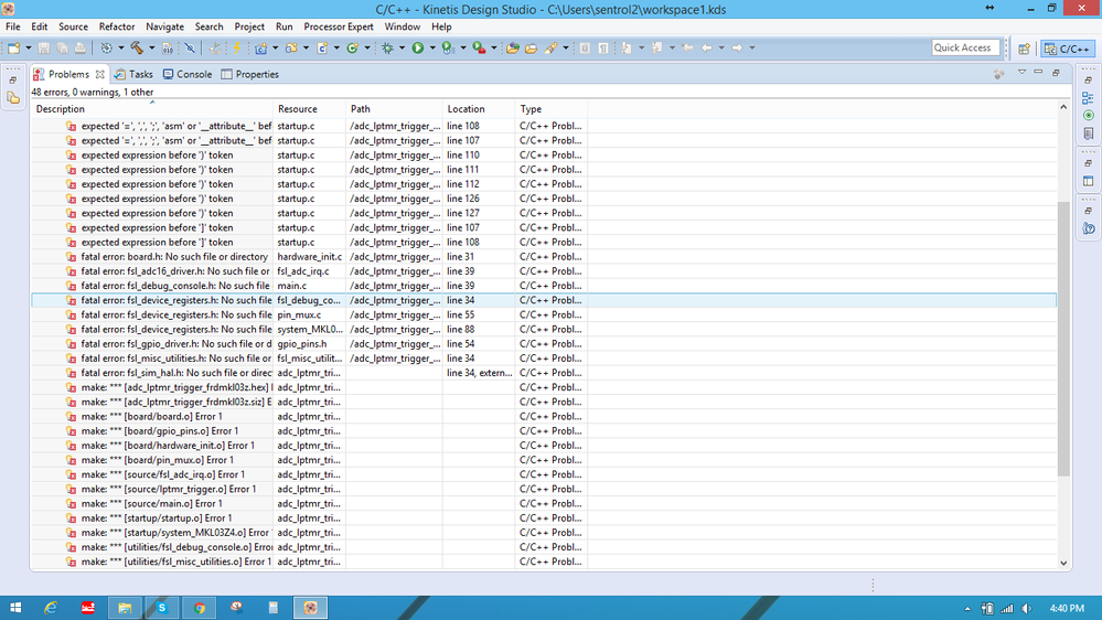

syedidris
I did same as matherin,
but not getting float printing, I getting error like this,
plz anyone clarify this doubt.
4,857件の閲覧回数
DavidS
Hi Syed,
What processor are you using?  Looking at the errors it seems like KL03.
The above post were asking for printf/scanf with floating point support.  Is that what you want too?
If yes attached is an example project for the FRDM-KL03Z.
Note that KL03 on the Freedom board is limited to 32KByte flash and very limited to 2KByte of SRAM.
Because of that I had to increase the compiler optimization to get the linker to work.
David

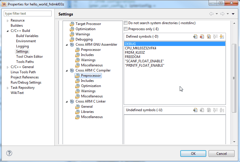

syedidris
David sir,
Thanks for your reply.
Actually I am a beginner, and yes you are right, I am using KL03 processor.
And I don't know about processor expert. I am trying to learn with demo codes provided with KDS3.0.0 IDE. when I am trying to print the float value like,
float a=2.4;
PRINTF("%f",a);
I am getting output as ' f ' only, so I searched on forum and enabled the option -u_printf_float with the following:
Properties -> C/C++ build -> Settings -> Cross ARM C Linker -> Miscellaneous -> Use float with nano printf
But, no change in the behavior of printf.
I will be thankful to you if you solve my problem
4,857件の閲覧回数
DavidS
Hi Syed,
Please open your Properties of your project and add the following SCANF_FLOAT_ENABLE and PRINTF_FLOAT_ENABLE....recompile and run again.
David

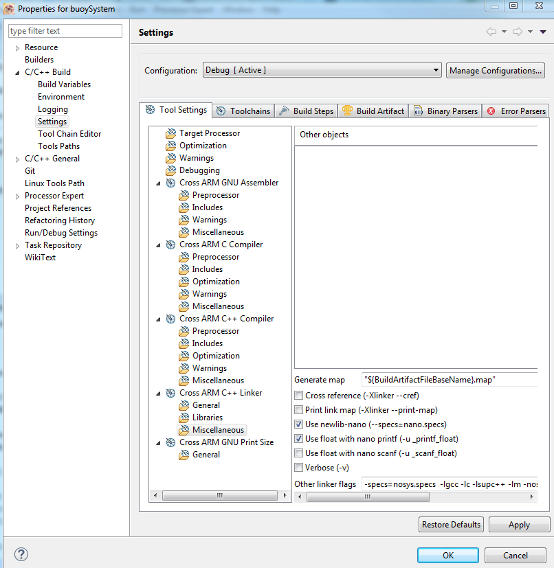

matherinewang
I have add -u _printf_float to the linker options to enable float/double support to printf/sprintf(), but still can not work with float, any other configuarion needed?
