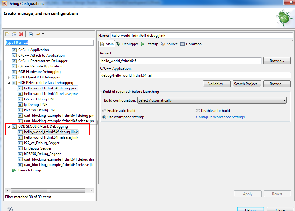

Hello Rotert,
I use the USB connect the OpenSDA(J26) port of board , then use the j-link to download , when disconnect the usb , then connect it
again, it can work well .
Please take screenshot about your configuration when debug and the connect of your board . And i recommend
you first test one simple project .
Alice

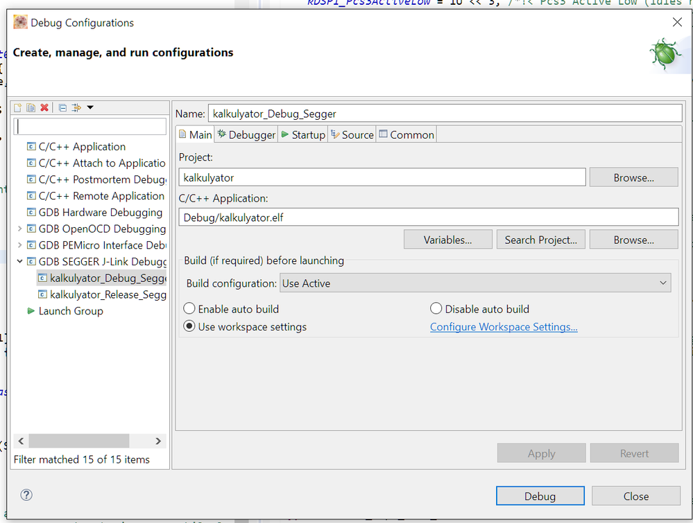

robertbaruch
Here is my debug config. I am also using the J26 port and j-link.
Debugging works just fine, but when I unplug the USB and plug it back in, the board does not start the code. I have to download it to the board again.

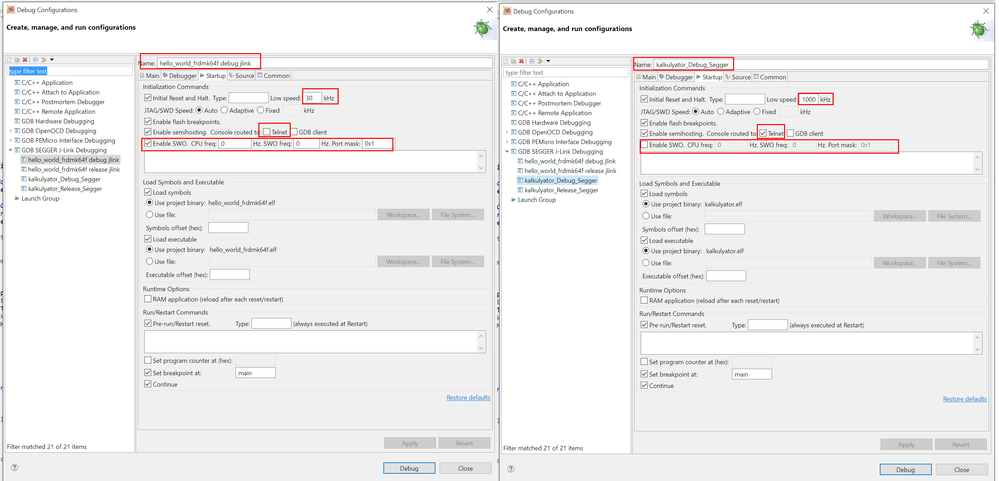

robertbaruch
Yes, that example works: I'm able to run it, disconnect the USB, reconnect, and the program on the board immediately starts up. Now we need to figure out why it doesn't work with KSDK 2.0.
Here are the differences between the example project and my project for the Debugger and Startup settings. Which would cause the program not to stay on the board?
