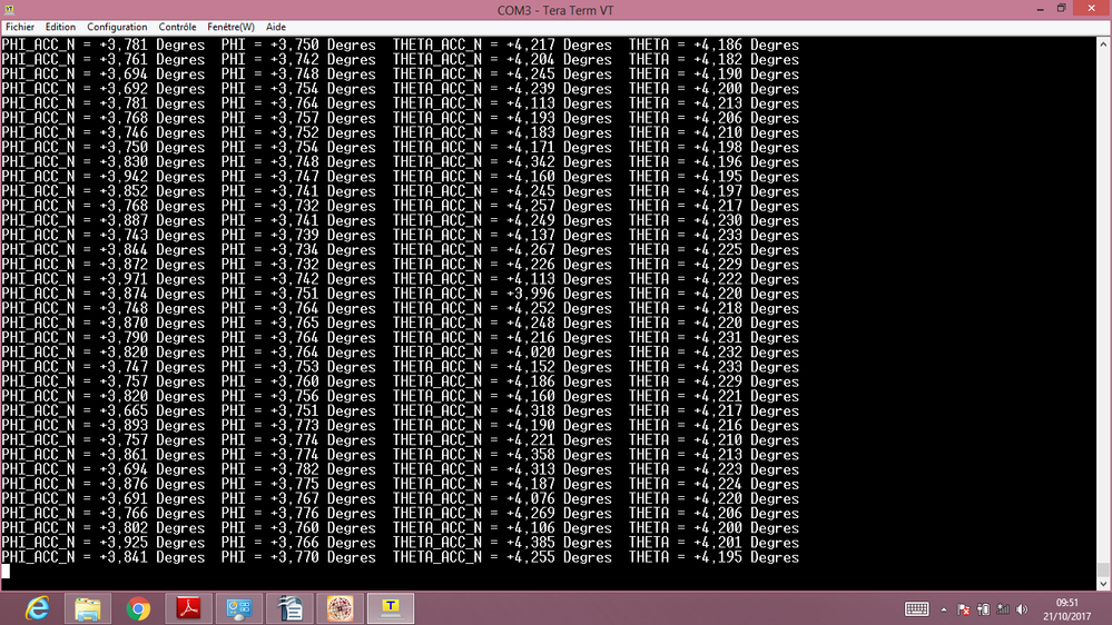

  • I Use KDS (Version3.2.0) with Processor Expert. The processor is MKV10Z32 and my emulator is PE Multilink Universal.For the first time, I get a flashing Issue :
    I was able to easily create a project, create and configure LDD Component, Generated software,built the project, and debug software. Then the project is running well on the emulator.

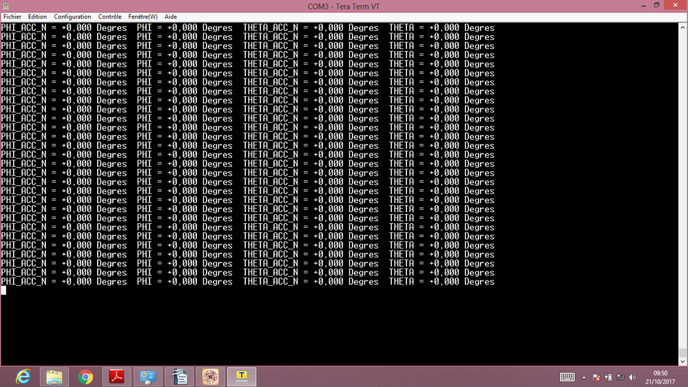

    But, if I flash, I get a File (No source available for "0xfffffffe") and when I reboot(with power on), I get get a programm running with value at zero.
    Nota : If I run the program under emulator, and then I disconnect the emulator without power off/on, the application continue to run well.
    Thanks for help
    Application is an IMU sending data to Teraterm terminal via SCI1.
    Screenshot on emulator (or when I disconnect the emulator without power off/on: Values are OK
    Screenshot on micro after flash and power on: Values are zeros everywhere

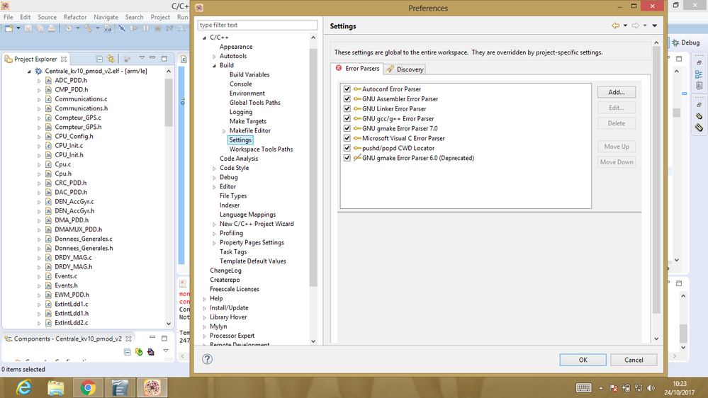

"No source available.." basically means that the debugger cannot find the source file for that given address. One reason could be that you have turned off debug information (see No Source Available… | MCU on Eclipse )?

robert2000
Hello Erich
Thanks a lot for your answer.
There is may be a sprint function Issue as mentionned by Alice
But the « No source available for "0xfffffffe" «  is may be be another real Issue. I read your note and try to go to eclipse menue. But KDS has a different presentation and I didn't find out the strip symbolic information.
I went through the preference menue and find the following.
Do you have any idea ?

robert2000
Hello Alice, Thanks a lot for your answer.
There is something right in what you are investigating.
As, I mentionned in my note this an IMU application.
I do not use print but I use sprint to convert float to char for gyro and Acc Measurments. And I have the Issue.
But for the GPS application at this point, I doesn't use sprint. And the flashing is OK.
In fact,as sprintf is not working for float, I did 2 functions to convert float to char(using sprintf only for int) and send via SCI1 (Sorry it's french base):
