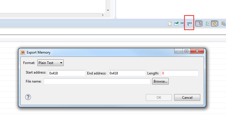

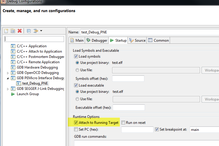

first I suggest you check if you check if your code was successfully downloaded to flash with "Flash from file...".
thus you need attach a running target before launch.  thus KDS can launch debugger and connecting the running target without erasing flash. then we can check memory window if your application burning file is correctly programmed. I suggest you dump the flash content to a file to compare both of the two cases. refer below screenshot and video attached.
secondly, I suggest you attached the target and view trim field. if the trim value is the same in both of cases (via debug mode but does not run via "Flash from file")
