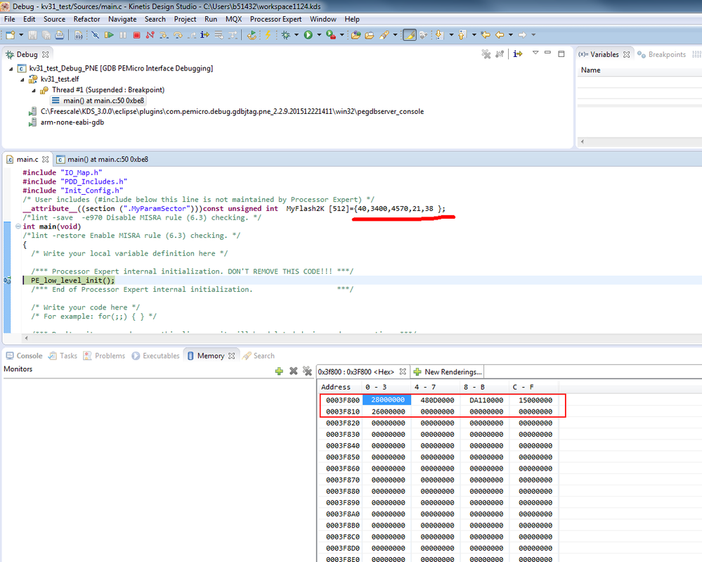

In a .c file i declared
__attribute__((section (".MyParamSector")))const unsigned int  MyFlash2K [512]={40,3400,4570,21,38.....
In this way in KDS,at debug, the declared array MyFlash2K[512] is placed at correct address 0x3F800 but the Memory viewer shows that
the unsigned Int values are all =0xFFFFFFFF,instead of 0x28,0xD48...

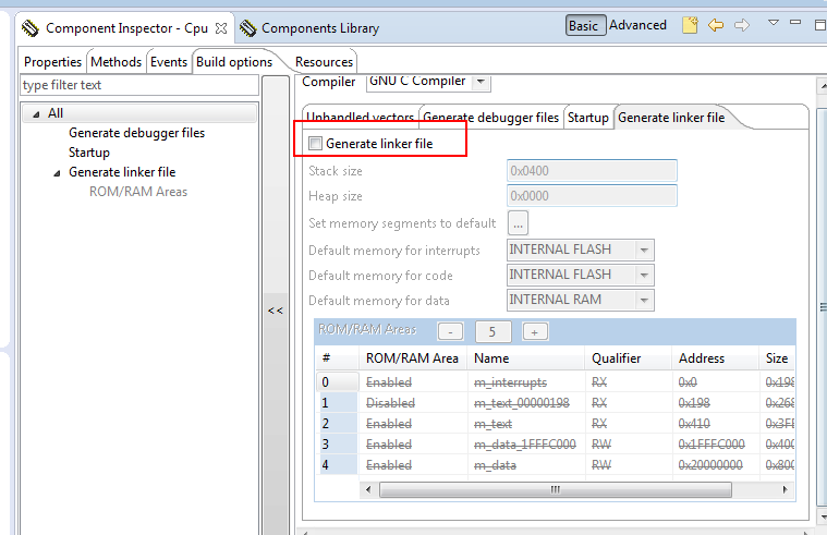

I modified the ProcessorExpert.ld file to reserve the last 2 flash sectors for my non volatile parameters,
then i deflagged the "Generate linker file " option in the PE Build Options:

diegocolombo
The only way i have found to have the start of the sector with initialized values{0x40,...etc) is to declare the array with size of 256 instead of 512.
The strange thing(at least strange to me) is that restoring the size of 512  the values are still initialized{0x40,,..etc)...
I can guess that it is because the memory is not erased at that address, unless the linker or the compiler decide to assign some value in that sector....in other words i'm still walking in the fog

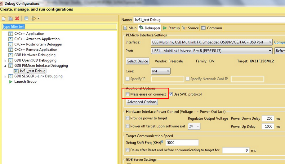

Does the the data of other flash memory is right ?
You can select the "Mass erase on connect" to erase the flash before download the project :

- Pay attention that , in the PE project , if you change the linker file by hand , not configure the PE ,
please disable the "Generate linker file " , then build the project .
Alice Yang

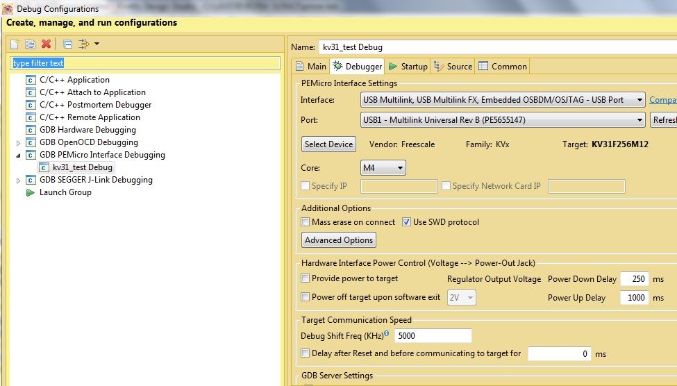

I forgot to say that i'm using a P&E Multilink as debugger and this should be the only difference,so i did a debug configuration for it.
There are no preserved areas in Advanced Options.
Selecting the device in the debugger window i have to choose MKV31F256M12, the closer to my MKV31F256VLL12 device.
Is this correct??Can it lead to any problem?
Of course i did not touch any PE settings,and even in my original project the "Generate linker file " option was not selected.
