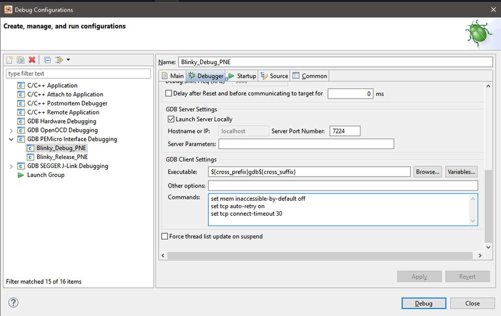

Hi, everyone.
I was making a new project and use the option "File > New > Kinetis SDK 2.x Project", after this, I just tried to build (worked well) without change anything and after I tried to debug this project, but unfortunately this error appear and I can't solve it.
I found others links talking about "Launching: Configuring GDB Aborting Configuring GDB", but didn't help. All those links just said to copy that text in Commands' box:
set mem inaccessible-by-default off
set tcp auto-retry on
set tcp connect-timeout 30
I did this many times, restart the KDS, reopen a new project, unplugged the USB Cable, but I'm still stuck.
*Observation: Other projects, like "bubble" that I tested (a demo program), build and debug and it occurred without problems.
Thank you! :smileywink:

I just changed of PC and works well. Probably something was wrong with the other compiler or some drives.

the error message "Launching: Configuring GDB Aborting Configuring GDB" is usually caused by a wong debug launch configuration.
Can you check Solving “Launching: Configuring GDB Aborting Configuring GDB” | MCU on Eclipse  and GDB Client and Server: Unlocking GDB | MCU on Eclipse  if it does help?

Hi Tiago,
Please use the latest version KDSv3.2:
Kinetis® Design Studio Integrated Development Environment (IDE)|NXP
Hope it helps
