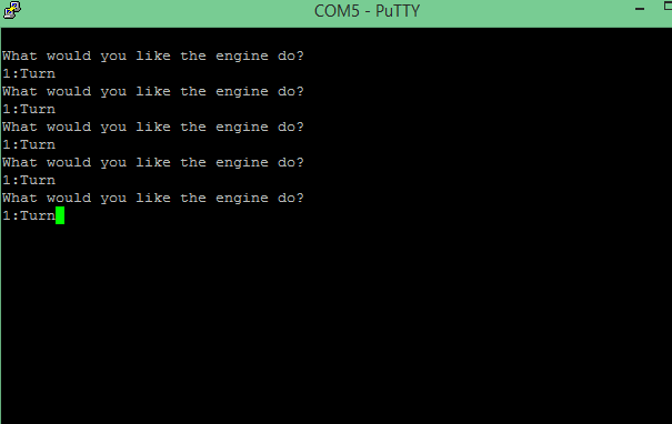

Error in final launch sequence
Failed to execute MI command:
-target-select remote localhost:0
Error message from debugger back end:
localhost:0: The requested address is not valid in its context.
It happened when I debug/run the code. What did i do wrong?

Have you terminated any pending debug session? You might get such a message if you try to debug twice the application (the applicatino is already debugged, and you start a second launch).

Hi Eric,
I guess it was and currently it is working now but it wont print out entire content. I will post my code and screenshot above.

yarannan
Hi Alice,
Its running on KDS2.0. Thats my own project. It's running now but it wont print entire contents.

yarannan
Hi Alice,
Sorry about that. I attached new project there. I was running another project earlier this morning and I ran into same thing.
Honestly, I was copy and paste ksdk baremetal code into mqx project. That might cause some fatal issue... but i dont know where...
