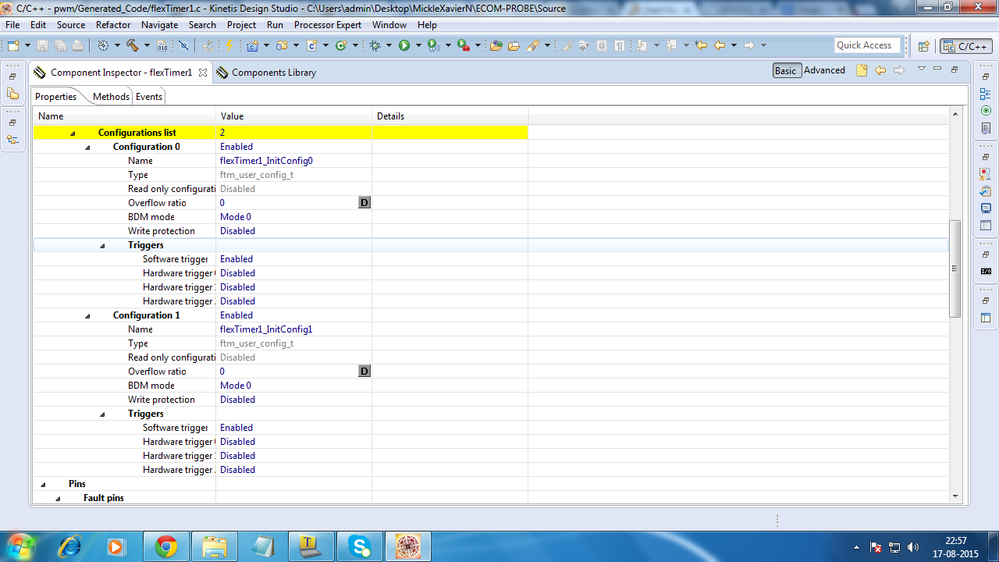

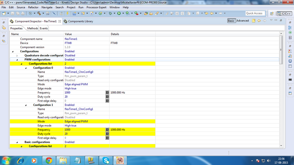

We  are using KDS 3.0.0 and ksdk 1.2.0
We need to generate pwm output with different dutycycles given in code.
we used fsl_ftm component for pwm
But the dutycycle remains same,( means the one which we give at the time of code generation using processor expert.)
Can anyone  help me to overcome this problem.

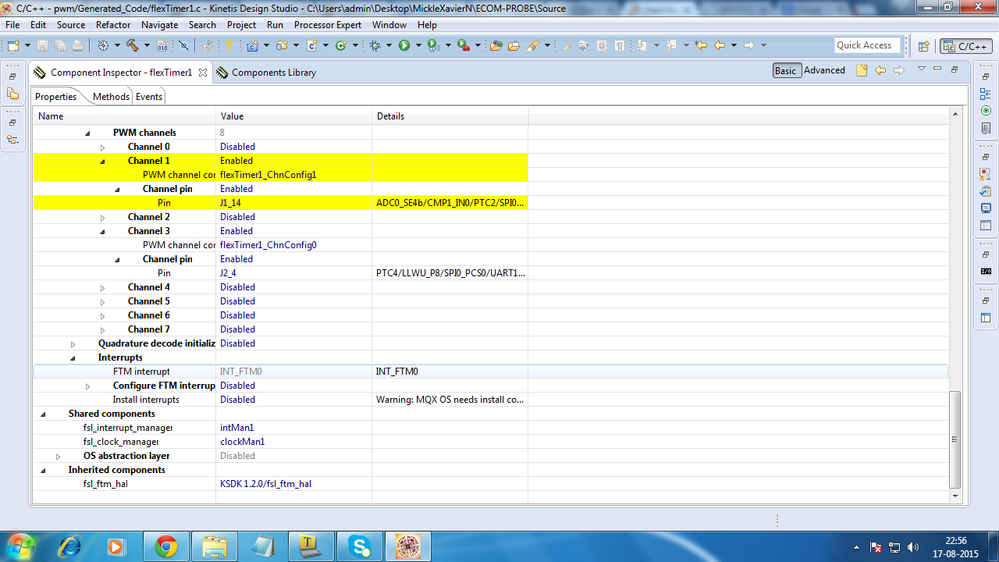

Now I can update the PWM Duty cycle in code by the below codes....Also can able to run multiple channels with that fsl_ftm component(FTM0)
FTM_DRV_Init(FSL_FLEXTIMER1,&flexTimer1_InitConfig0);
FTM_DRV_CounterStart(FSL_FLEXTIMER1,kCounting_FTM_UP, 0, 0xFFFF, false);
flexTimer1_ChnConfig0.uDutyCyclePercent=50;                                                                 //vary the duty cyce of channel 1
FTM_DRV_PwmStart(FSL_FLEXTIMER1,&flexTimer1_ChnConfig0,3U);
flexTimer1_ChnConfig1.uDutyCyclePercent=90;                                                                //  vary the duty cyce of channel 2
FTM_DRV_PwmStart(FSL_FLEXTIMER1,&flexTimer1_ChnConfig1,1U);
FTM_HAL_SetSoftwareTriggerCmd(FTM0_BASE_PTR, true);
