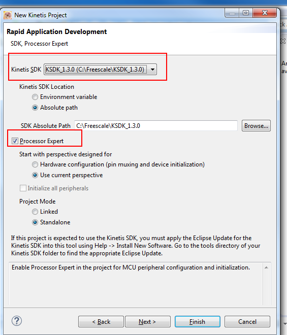

In the past I used CW & Processor Expert to build a framework on Coldfire MCUs for projects which worked out very successfully. Now I plan to do the same with Kinetis for a range of new projects (for the time being I do not plan to use an OS) and use PE to get up and running quickly.
Having briefly looked through a few docs for KSDK and KDS, I think I do not need to install KSDK, can someone correct me if I am wrong.
Can anyone also explain why the PE functionality appears to be duplicated in KSDK? It all seems a bit confusing.

Hello Ernest,
Which chip do you use ?
About the PE and SDK+PE ,  you can consider like this : There are two frameworks PE and KSDK+PE, the two PE are difference , they have no relationship.
The former PE almost the same as the PE on CW; the KSDK+PE is a  new one .
Some chips only support the KSDK , for in the future , all the kinetis chips will support the KSDK .

Hi Alice, thanks for responding.
I will probably start with the K26. As I have many projects and the price of the MCU is not important, a super-set device would be flexible for me.
I really like the conventional PE, it is vary sad to see that it will be phased out.

Hello Ernest,
Sorry for maybe i cause misunderstanding to you .
The KSDK also can through configure the PE to development :
Hope it helps
