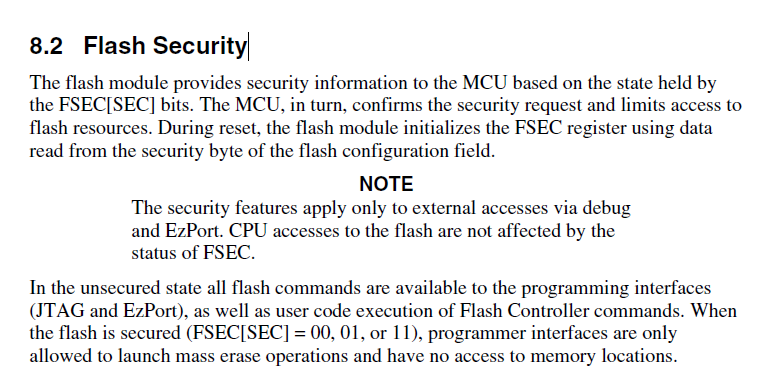

Hello Spencer,
- The reason for  " device is secure " is in the code have download into flash set
the register of FTFA_FSEC ->SEC =00 , 01 or 11 :
When the flash is secured programmer interfaces are only  allowed to launch mass erase operations and have no access to memory locations .
So you can   set the FTFA_FSEC-SEC to 10 , then you still can use the debugger to accesses it .
- About the detail Flash Security , please check the Reference Manual for KV31: pastedImage_2.png

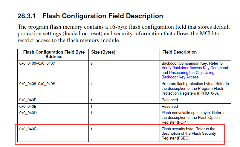

- The FSEC register is read-only register , during the reset sequence, the register is loaded with the contents of the flash security byte in the Flash Configuration Field located in program flash memory.  So please configure the Flash configuration field byte Address 0x0_040C .
