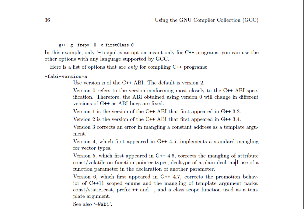

I'm playign aroung with compiler flags (using KDS 2.0.0)  to see how this impacts on code size/performances/etc.
One question (I'm using C++):
- what is ABI version? What setting should I use? It is safe to go to the maximum (7) or is best to keep the toolchain default (2) or set for the most conforming (0) ?
Regards Giacomo

hi giacomopertrini,
Freescale has document
{KDS_2.0.0 install}\doc\pdf\gcc\gcc\gcc.pdf document related information.
see chapter 9:
the different ABI version description is listed here:
can this help?
