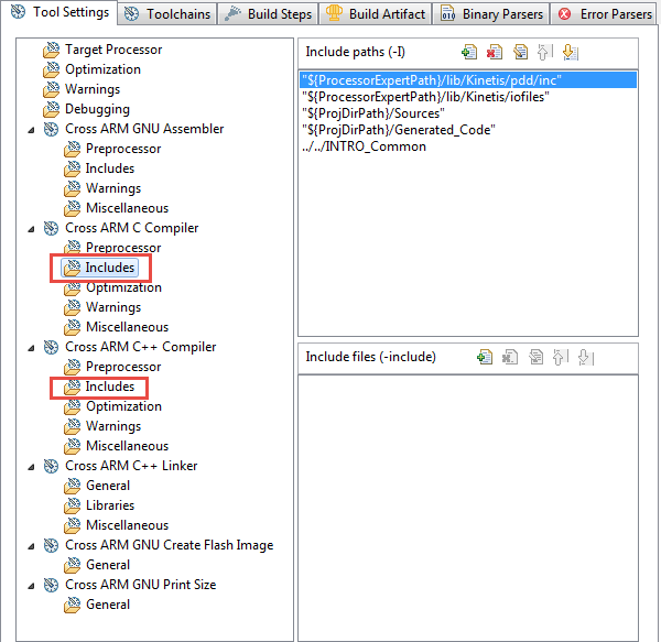

what is the proper way of including such files into project code?
I've tried #include "source_folder/header_file.h" but KDS says: Unresolved inclusion + No such file or directory.
If I try only #include "header_file.h" I can access it when use Open Declaration but during building KDS says: No such file or directory.
Best regards.
2,291 次查看
BlackNight
Make sure your folders with the header files are listed in the Includes settings of the project:
If using C++, make sure you add them as well under the C++ compiler.
You can copy/paste items in Eclipse, see Adding Multiple Include Paths to Build Settings in Eclipse | MCU on Eclipse
