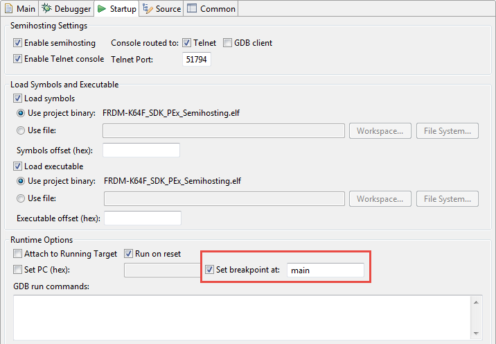

BlackNight
Hi Adam,
The temporary breakpoint is set because of a setting in the debug configuration here:
The above screenshot shows this for P&E, but is in a similar place for Segger J-Link and OpenOCD.
"No source for xxxx" shows up if GDB is not able to locate a source file for that PC register value. I had noticed this one too, but was never a problem to me. You might be able to get rid of it if you extend the GDB script to set the PC.
