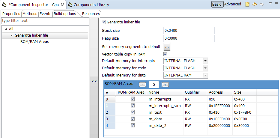

But I cannot see RAM and FLASH configurations in Generator_Configurations as below.
Should I change below Generate linker file settings?
Please advise as soon as possible.

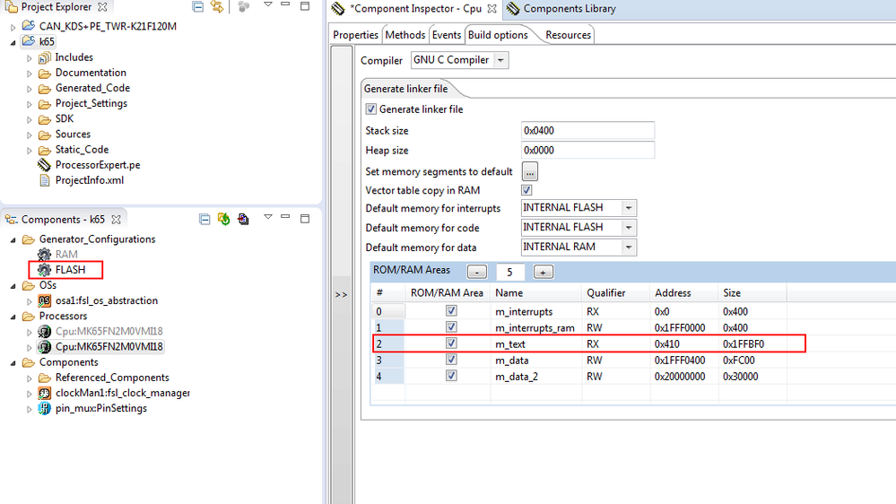

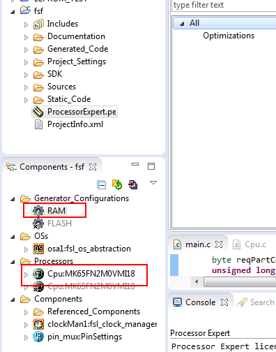

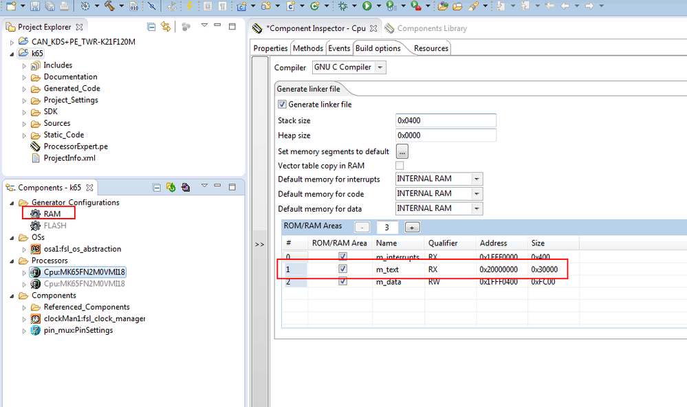

Hello lsao,
You can compare the configuration when select RAM and FLASH:
RAM:
FLASH:
If you want use the KSDK v2.0, you can refer to the generate code the KSDK1.3 .
Hope it helps
