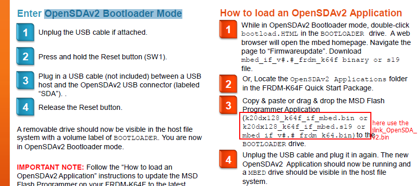

Hello Mike,
- I think you maybe misunderstand me , you said this
and you also said use the openocd to debug , if this is your demand , you need first download the bootloader i mentioned,
this bootloader is made by mbed.
- While there are three method to debug the two board , no matter you use which method , please first update the firmware (bootloader),
for the FRDM-K64 example , please refer to the "FRDM-K64F Freedom Development Platform -Quick Start Guide.pdf" ->  page6
to update . for example use the j-link to debug pastedImage_1.png, you can download the "JLink_OpenSDA_V2.bin" to the bootloader,
then use one usb plug in the J26 of FRDM-K64 board , it can debug directly.
Hope it helps
Alice

Now I am having trouble with the update...
This is on a mac  El Cap 10.11.3
When I plug in the frdm-k64f the green light near the connector comes on solid
When I plug in the connector with the reset button pressed, the green led is on for about a second and then off for about  a second.
When it is blinking, I am expecting a drive named BOOTLOADER to apper in the finder, but it does not. No new drives appear.
I have not tried this on Windows yet.
