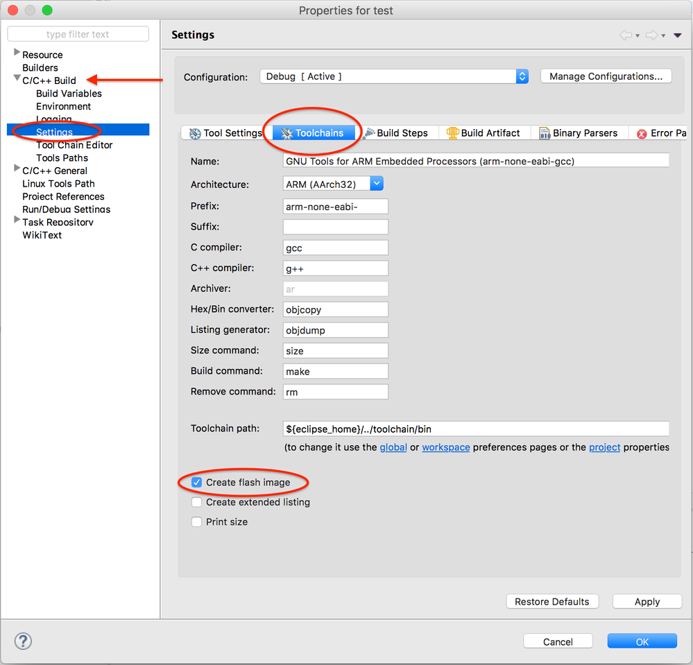

From the top menu select
Project -->  Properties

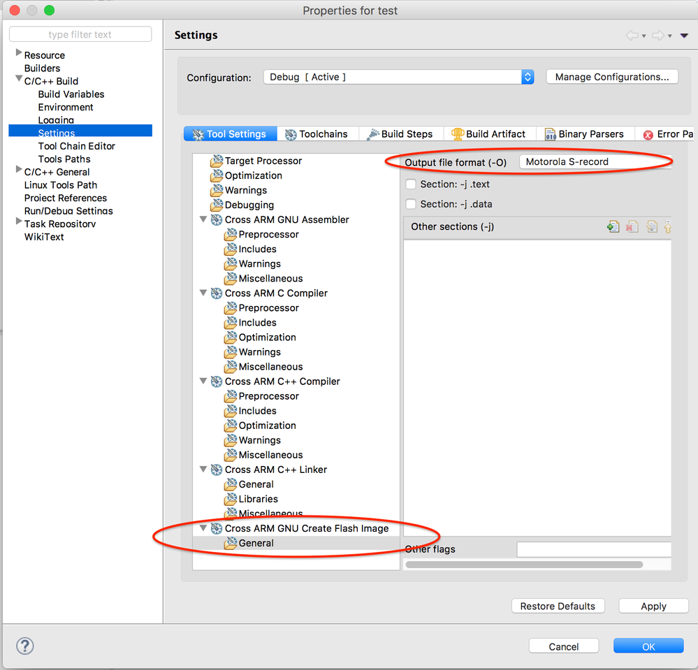

Then in the left-hand pane select   "C/C++ Build" --> "Settings"  then select the toolchains tab/button in the dialog box that appears.  In the dialog box select/check "Create Flash Image"
Next, select the Tool Settings Tab  - you'll see a folder tree appear within the dialog box.   In that folder tree select  "Cross ARM GNU Create Flash Image" --> "General"
Toward the upper right where it says Output file format (-O)  Select from dropdown "Motorola S-record"
Now the *.srec file will get generated
