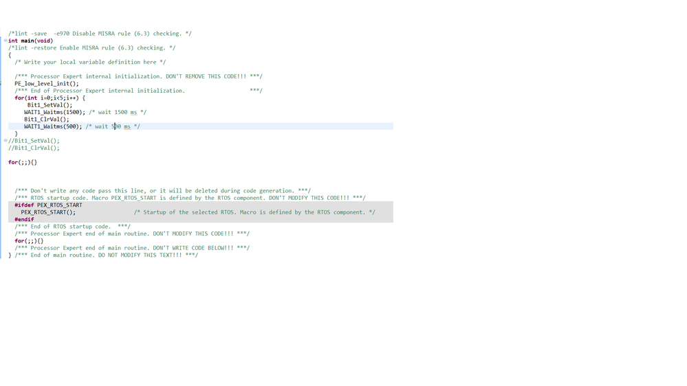

I tested what you suggested and this is working,  turning the led on  and off.
When I changed it to run only  five times, it acted the same, but at the end it left the led turned on.

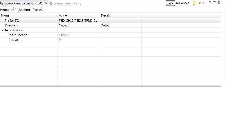

This is how I define the BitIO:
and my main is:
Avner
