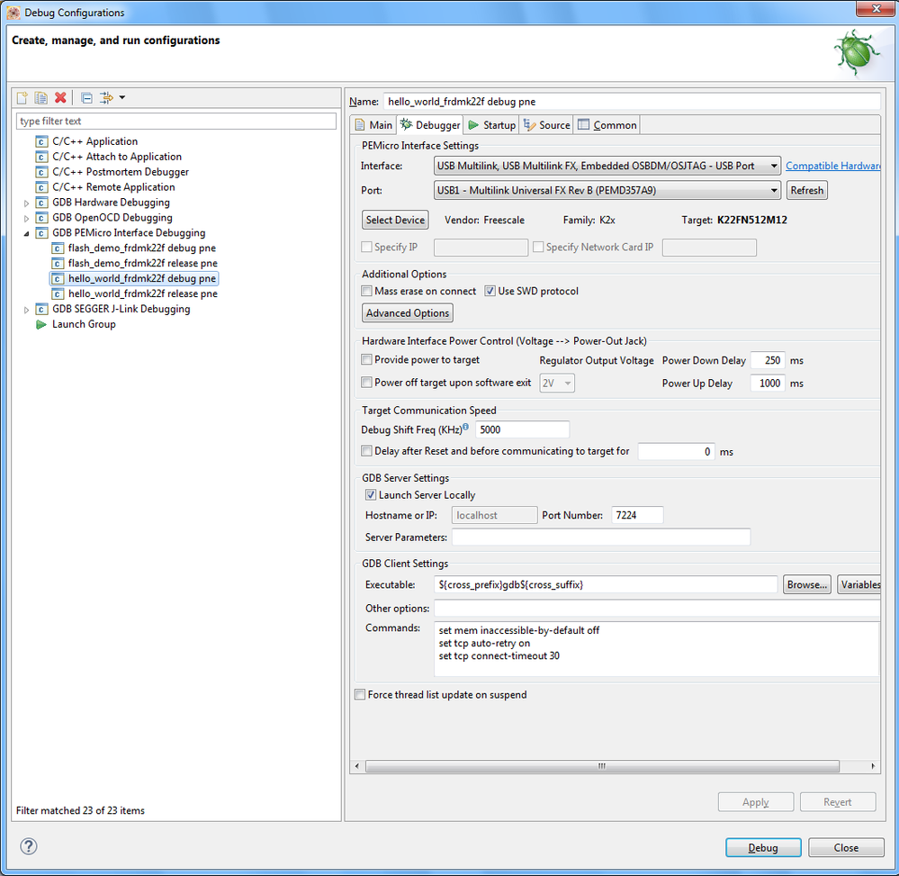

But now we are moving toward using our custom hardware which won't have an OpenSDA interface, so I am attempting to connect directly to the FRDMK22F K22F MCU using a PEMicro Multilink Univeral FX probe connected to the J11 connector on the FRDMK22F.

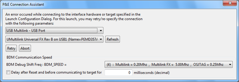

KDS appears to connect fine to the PEMicro Multilink Universal FX probe, but fails when attempting to debug the hardware.
We have cut the J7 trace as indicated in the FRDMK22F User's Guide, to isolate the MCU from the OpenSDA debug interface.
The FRDMK22F is being powered by an external 5V power supply, and the TargerPower present LED lights up on the PEMicro Multilink Universal FX probe.

It appears likely that my problem were likely simply the result of a process left running on the debug host, in this case Windows 7.
At times pegdbserver_console.exe gets left running and future debug sessions will not start until that gets killed manually.
This issue is resolved.

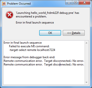

When I attempt to launch the KDS debugger to run the simply hello_world on the FRDMK22F I get the following.
The code which was running on the hardware was toggling the RDB LED.  When the Debug is initiated that toggling stops.  But the debug fails and once I remove the cable from the PEMicro probe and reboot the previous code is programmed and run.
The debug fails, nor does it update the flash of the device (as the programmer normally does when it works using the OpenSDA interface).
Steve
