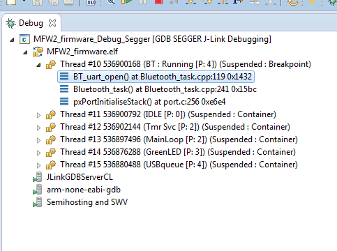

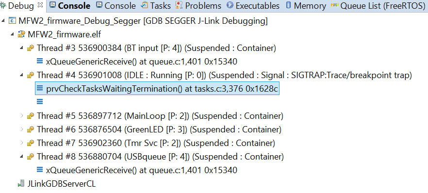

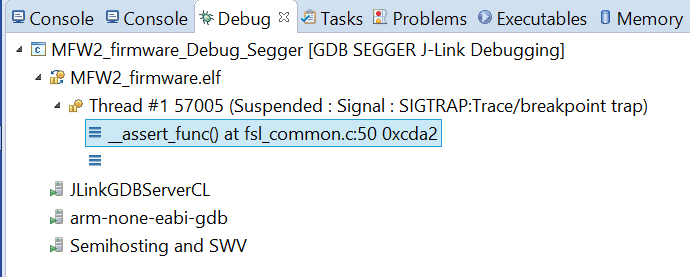

Unfortunately I cannot:
- see a stack call trace when the program is paused (though it shows the current routine)
Here's a snapshot of an assert infinite loop I paused showing missing stack call trace

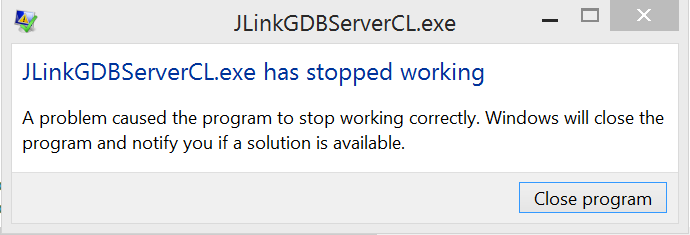

Segger reproduced the problem and suggested adding the following option in the debugger configuration "other options" field:  -RTOS GDBserver/RTOSPlugin_FreeRTOS
Unfortunately that results in the debugger crashing first time it hits a breakpoint:

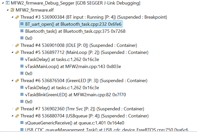

Hi Dave,
I have not faced such an issue, and I'm using that functionality on a daily base with complex projects.
I'm using
SEGGER J-Link GDB Server V6.12a Command Line Version
JLinkARM.dll V6.12a (DLL compiled Dec  2 2016 16:44:26)
with the original GDB of KDS V3.2.0:
GNU gdb (GNU Tools for ARM Embedded Processors) 7.6.0.20140731-cvs
(you get the above information in the console view).
One thing you could check is the output of the console for Segger and the FreeRTOS plugin, see Adding FreeRTOS Thread Awareness to GDB and Eclipse | MCU on Eclipse
The plugin needs some data structures in the FreeRTOS kernel available to work best. I have posted my log below as a reference. Other than that, because this is a crash in the Segger library (which is owned by Segger, and I'm sure they want to fix it), have you reported this on the Segger forum already? Segger is very responsive.

Here's an example of the FreeRTOS task viewer showing multiple threads (tasks), with no call stack information (just shows the point where the thread is blocked instead of the complete call stack):
From Segger, here's and example of a correct display on Windows 7:
NXP - Any hope of getting this fixed??
Best Regards, Dave

Erich Styger wrote: ... The other thought I have is this: have you already configured this in FreeRTOSConfig.h
#define configTASK_RETURN_ADDRESS   0  /* return address of task is zero */
Because this terminates the stack with a zero return address. Otherwise, depending on the GDB version, this can confuse GDB (still, the Segger DLL shall not crash).
OK, I added this configuration setting. While the call stack displays goofy "called from 0", it is finally usable:
Thanks Erich!
Again: this along with the above (1-3) should be done in all NXP FreeRTOS examples and NXP-wizard-generated FreeRTOS projects!! NXP is making hard for customers by not setting this up in the first place!

davenadler
Senior Contributor II
Apologies Erich, I skipped a few steps required to avoid crashing and get FreeRTOS task viewer functioning; this from Segger. I've done all of these:
  1. Set configUSE_PORT_OPTIMISED_TASK_SELECTION to 0
  2. Added to the debugger options: -RTOS GDBserver/RTOSPlugin_FreeRTOS
  3. Create a dummy symbol uxTopUsedPriority (will be preferred to uxTopReadyPriority) and set it to configMAX_PRIORITIES.
