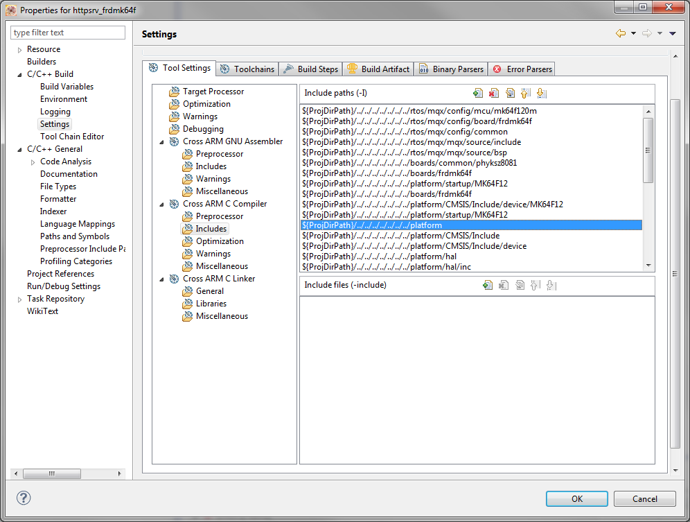

Last year I was playing with KDS 1.1.0, and I created a walkthrough for the httpsrv example to help others get going with the K64F.  I'm now at a point with my project where I'm going to really start spending time with KDS, and the first thing I did was to upgrade to KDS 2.0.0, as well as KSDK 1.1.0. Unfortunately, I am not having much luck with the httpsrv example, specifically in the scenario where I am copying the example via Import into a different folder location.
When I do this, it seems that all of the dependency paths get mixed up.  For example:
See all of the ../?  There are way too many, and since my actual project directory is in a different branch of folders, there's no way to get to the necessary files from there.
First, it should be ${KSDK_PATH}, not ${ProjDirPath}/../../....  In addition, during the installation of KSDK, it asked me if I wanted to update the KSDK_PATH with the new folder location, and I said yes.  But it didn't and the old path remained.  Third, none of the Source files get copied over, so they have to be manually copied and added to the project.  There are probably more, and if it's really confusing I will release a new walkthrough document once I have the sample working.

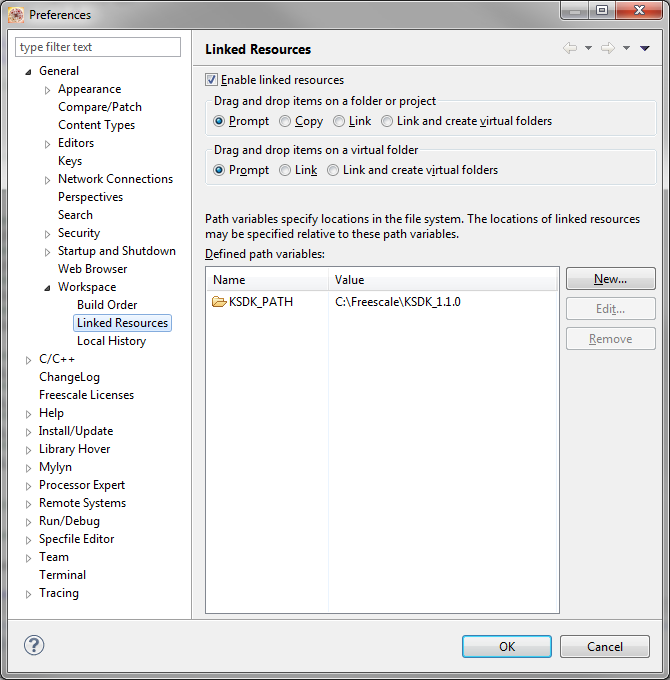

I think I've figured out a solution to the problem.  In posting this solution, I am hoping that someone out there will either realize what I had done wrong with my KDS installation, or the KDS team will see something that is a possible bug.

But that didn't work.  After more digging, I found out that Eclipse doesn't support environment variables like this by default, but instead it has a feature called Linked Resources that can be used to support path variables.  You can find this in Window -> Preferences -> General -> Workspace -> Linked Resources.  I modified mine like this:
After I added that and reloaded my project, bingo!  The file I located with ${KSDK_PATH} could now be opened in the editor.
It also turns out that if you make this modification to the "master" .project file found in the KSDK folder and then import it, the imported project works straight away.
