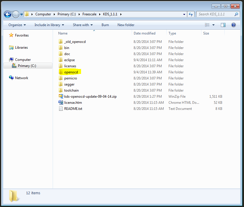

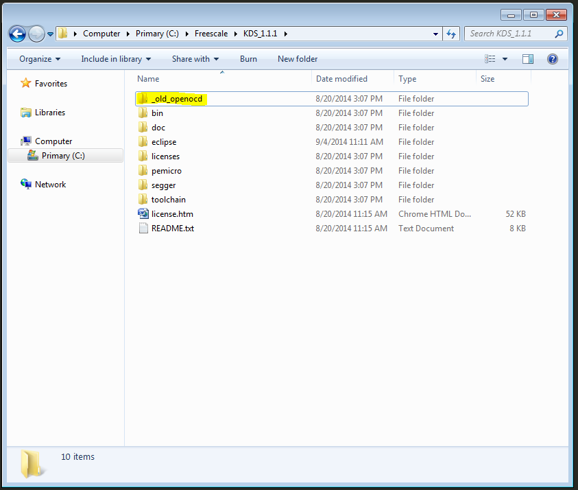

In Figure 1, you can see the folder named “openocd”. This contains all the files necessary for OpenOCD to run in KDS. Before we install the updated version of OpenOCD we must rename the “openocd” folder. This way we have the old version of OpenOCD, should you feel the need to return.
Figure 2: Renamed "openocd" folder.

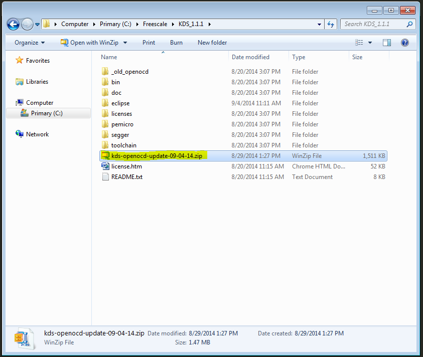

Once the “openocd” folder is renamed, as in Figure 2, we then need to download the “kds-openocd-update-09-04-14.zip” file attached to this document. Save this file into the KDS installation directory, as in Figure 3.
Figure 3: KDS OpenOCD update in KDS installation.

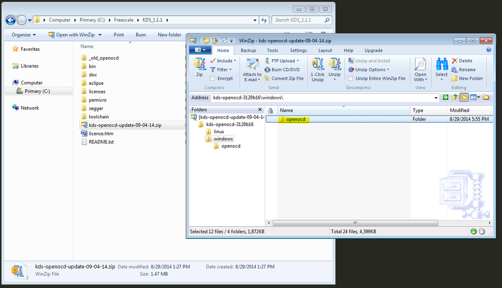

Once downloaded, extract the “openocd” folder for your operating system into the KDS installation directory. Figure 4 shows where the updated “openocd” folder is located for Windows users.
Figure 4: Location of updated OpenOCD folder for Windows.

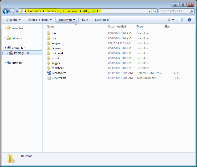

Once the new “openocd” folder is copied to your KDS installation the update process is complete. OpenOCD in KDS now supports the K22F family of devices. It is now possible for FRDM-K22F users to debug their KDS projects with CMSIS-DAP via OpenOCD. Figure 5 shows the KDS installation folder after successfully updating OpenOCD.
Figure 5: Updated KDS installation.

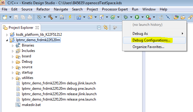

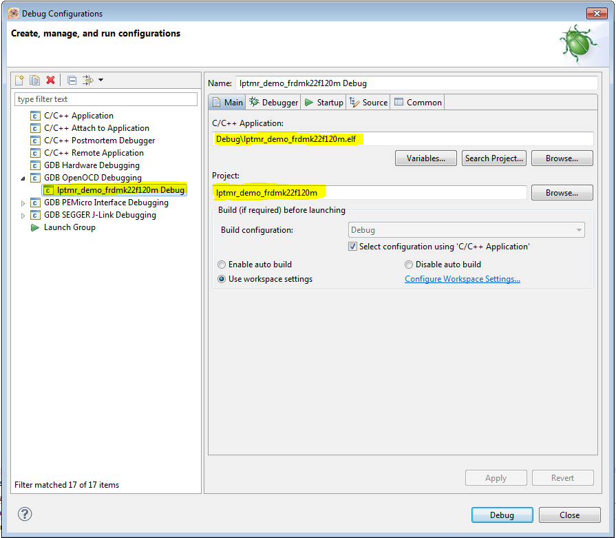

The first step is to highlight the desired project, and then select “Debug Configurations…” from the Debug drop down.
Figure 6: Open "Debug Configurations..."

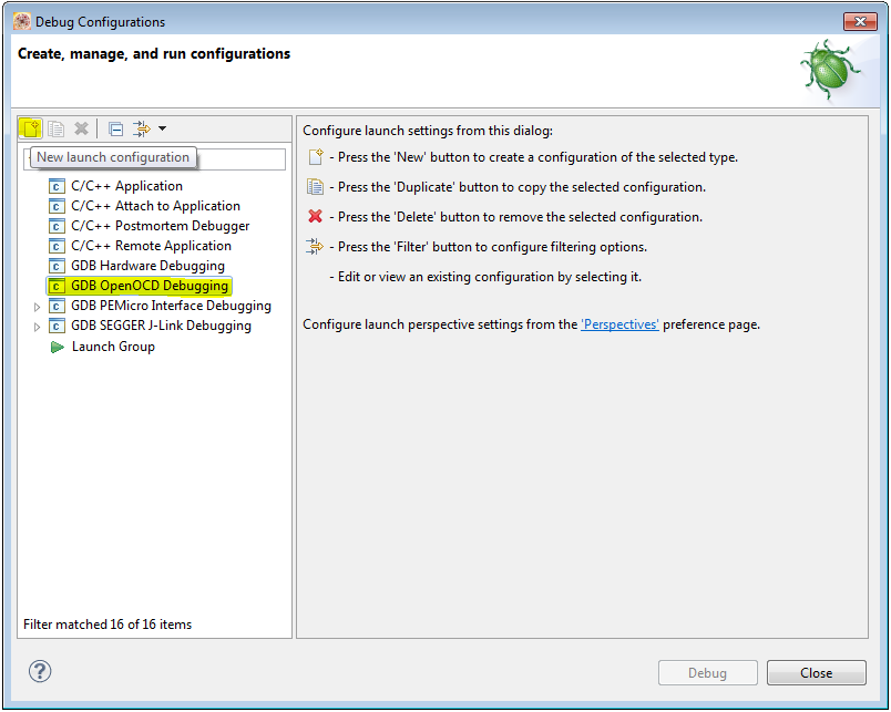

Once the “Debug Configurations” menu pops up on your screen, select “GDB OpenOCD Debugging”, then click on the “New Launch configuration” button in the upper left of the window. Figure 7 shows where these items are located.
Figure 7: Create a new GDB OpenOCD Debugging configuration.
The new debug configuration should automatically pull in information from the selected project. If an .elf file exists for the project, then the “C/C++ Application” and “Project” fields will be populated as in Figure 8.
Figure 8: These fields should be generated automatically if the project has already been built.
If the “C/C++ Application” field is not populated, you can search your project for an .elf file using the “Search Project…” button below the “C/C++ Application” field. If no .elf exists, then it is necessary for the user to build the project to generate the .elf file.

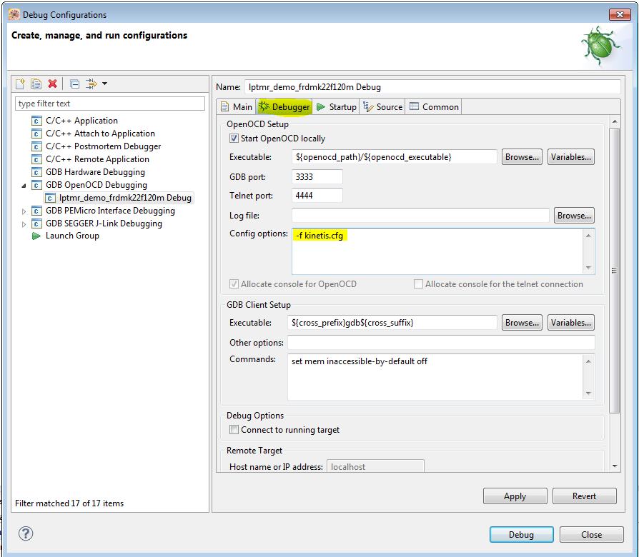

Once the “Main” tab has been completed, it is time to move onto the “Debugger” tab. In the “Debugger” tab, it is necessary for the user to define the configuration file in the “Config options” field. For debugging in KDS, OpenOCD will need a configuration file, and the default configuration file is “kinetis.cfg”. Enter “-f kinetis.cfg” into the “Config options” field. Figure 9 shows the correct input for the “Config options” field. After populating the field, the user can now press the “Debug” button to begin debugging.
Figure 9: User must enter “Config options”.

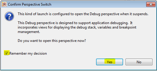

If this is the first time debugging in the current workspace, a dialog box will appear prompting you to open the “Debug” perspective. You should check the “Remember my decision” box, and press the “Yes” button. This will allow KDS to switch to the “Debug” perspective, for you whenever you begin to debug an application. See Figure 10 for more detail.
Figure 10: Select to automatically change perspective when debugging.

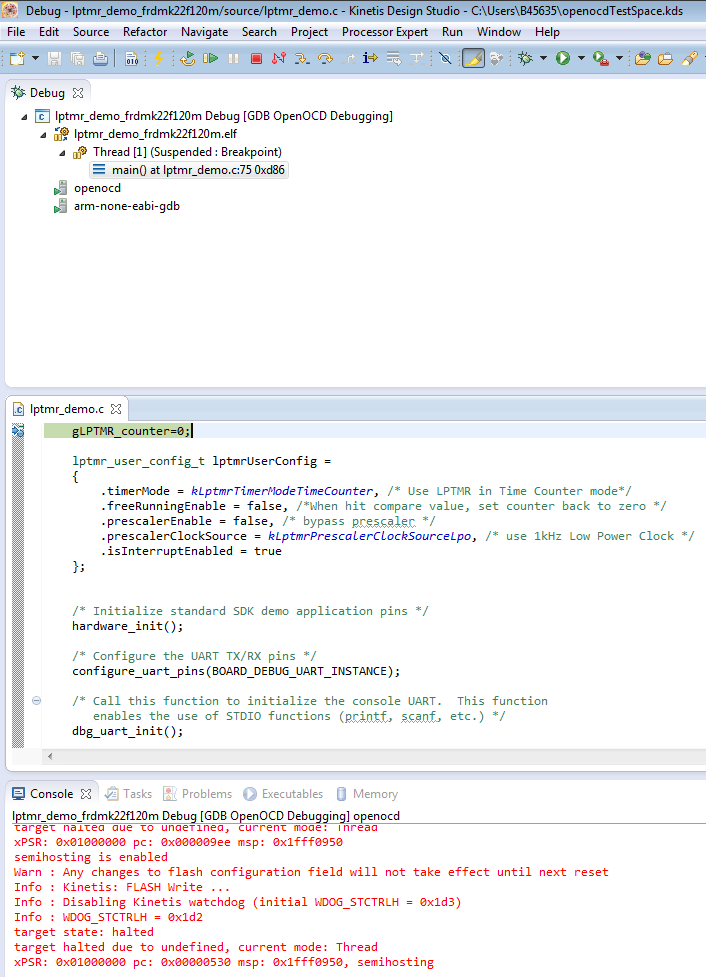

Figure 11, below, shows a successful debug connection to the target device using OpenOCD. The application has run to “main” and is waiting for the user to interact with the debug session.
Figure 11: Once debugger has connected and run to main.
