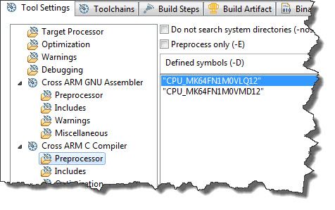

  4. ISSUE: After creating a project for MK64 devices that uses both Processor Expert and KSDK users may see build errors: "No valid CPU defined" fsl_sim_features.h.
    WORKAROUND: This can be worked around by adding a pre-processor definition supported by fsl_sim_features.h to the Projects C Compiler pre-processor settings. For FRDM-K64F make sure the following two symbols are defined in tehe Preprocessor settings of the compiler: "CPU_MK64FN1M0VLQ12" and "CPU_MK64FN1M0VMD12".

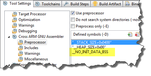

  5. ISSUE: For Kinetis SDK projects (both only SDK and SDK+PEx), global variables and library does not get properly initialized. A hard fault or undefined global variables are the possible result. This is caused by skipping some initialization code in the startup code.
    WORKAROUND: In the project settings, under Cross ARM GNU Assembler > Preprocessor, delete the "__START=main" and add __NO_INIT_DATA_BSS to the defines.

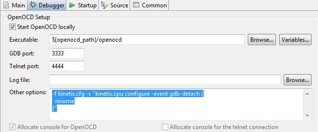

  8. ISSUE: 'Disconnect' from a running target debug session does not work as expected (e.g. halts the target).
    WORKAROUND: use this as 'Other options' in the debug configuration:
    -f kinetis.cfg -c "kinetis.cpu configure -event gdb-detach {
      resume
