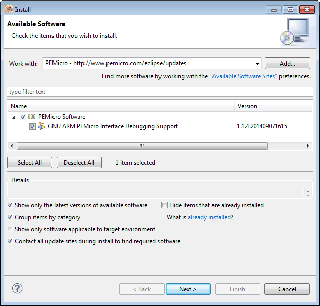

A new updated plugins is available from P&E with extended device support (see list at the end) for KDS V1.1.1:
NOTE: You need V1.1.1 for this update, as V1.1.0 has an issue with updating the P&E plugins, unless you apply a manual workaround. See the V1.1.0 release notes.
Use the menu Help > Install New software and use the PEmicro update site from the list:
Select the updated plugin, and press 'Next' to go through the installation.
At the end, you are asked to re-start KDS.

Hi Erich,
     How to add new product in KDS2.0, eg. KL33.
     I update http://www.pemicro.com/eclipse/updates in KDS2.0, but it still don't have KL33, how to solve it?
    Any reply will be appreciated.
Jingjing
There is a new P&E update (Updated P&E GDB Server for Eclipse: Connect/Attach and Advanced Flash Programming | MCU on Eclipse) which includes KL33 device support.
If you install the Kinetis SDK for KL43Z, it includes KL33Z support. To show it up in Eclipse, install the eclipse update in
C:\Freescale\KSDK1.0.0_KL43Z_1.0.1\tools\eclipse_update
I hope this helps,
Erich
Thank you very much!
My question is solved after installing the KSDK for KL43Z.
Jingjing
