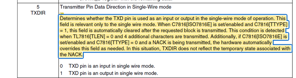

Hi Team,
Please support on below query for single wire mode-
We are using FRDM-K32L2B3 board as a master and setting RSRC and LOOPS bit as 1 to make UART as a single wire mode.
We are using below settings in our code to communicate with 1 wire maxim device, but facing one issue that TXDIR values is not changing to zero after successful transmission of data.
1,770 Views
bobpaddock
Senior Contributor IV
To my (perhaps limited) knowledge, Single Wire ISO7816E (for memory cards), and Maxim One Wire are different protocols.
Maxim is more like Mores Code and 7816E is NRZ.
