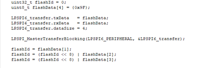

Hi all,
I'm using LPSPI module of K32L2A41VLL1A to send/receive data to/from External flash. My requirement is to first send command data with Rx buffer null and then receive the buffer with tx null. i.e., after sending command there's a second send/receive function to retrieve the received buffer. But I'm not able to get that data. Can you help me with the configurations I have to do so that the Rx buffer data is not lost during my second transaction?
Thanks in advance!
Shri
2,262 Views
hefan
After send command data with Rx buffer null, lpspi pull cs high.You can Transfer with rx no null and tx no null.
RT1170,for reference:
