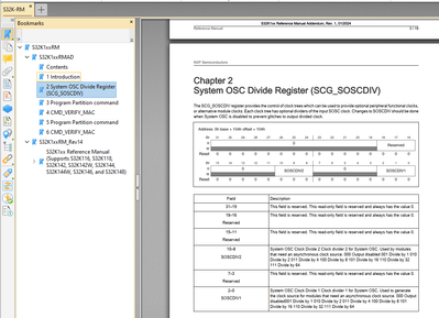

I would like to signal missing information about SCG_SOSCDIV register at page 602.
More precisely the description of bit 2-0 is missing.

PetrS
this is fixed within RM addendum chapter 2 of the RM rev14.1.
https://www.nxp.com/webapp/Download?colCode=S32K1XXRM
BR, Petr

xiangjun_rong
Could you tell us the part number you are using?
What is the documentation name and the chapter?
XiangJun Rong
2,739 Views
paolonese
Sorry,
I am using S32K118 microprocessor.
The documentation is the datasheet S32K-RM.pdf.
Chapter 28, pages 602, 605 and 606, 609 and 613.
