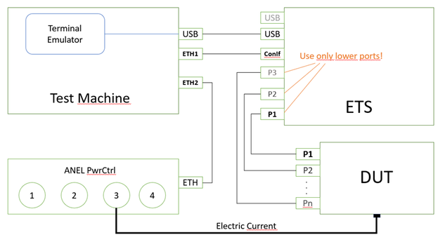

The following diagram shows how to connect between DUT and test system.
Figure 1. Connection of DUT and test system
The IP address of the ethernet interface which is connected to ETS shall be set to 192.168.5.2 and the netmask 255.255.255.0. To open a terminal emulator, the baud rate has to be set to 115200, data bits to 8, stop bits to 1 and parity to none. If DUT has 3 ports or more, the last port of DUT has to be connected to the Ethernet interface 3 of ETS.
