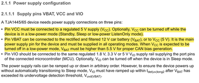

In 5V to VCC and VBAT , we will not be able to turn off 5V ? as mentioned in this image. one more query:if we give Vbat 24V will work? is there any limitation from current consumption perspective?

Hello Snehal,
The note says: “When VCC is expected to be turned off in a low-power mode, VBAT must be higher than 5.5 V for proper CAN bias generation.” This means the device expects VBAT to remain active when VCC is off, so if both are tied to the same 5V rail, you lose that flexibility. If you need low power modes (Sleep/Standby), you should keep VBAT separate from VCC. If low power mode is not critical, using a common 5V supply is acceptable.
Yes, VBAT range is 4.75V to 40V, so 24V is within spec. Current drawn from VBAT is very low as shown in Table 1 of the datasheet. Even at 24 V, the current remains in the microamp range, so power dissipation is negligible. The main current consumption comes from VCC (CAN transmitter), which is 6–60mA depending on mode. So, no major limitation for VBAT at 24V except ensuring proper filtering and transient protection.
BRs, Tomas
2,913件の閲覧回数
TomasVaverka
Hello Snehal,
Based on the datasheet:
- VBAT (battery supply): 4.75V to 40V
- VCC (CAN transmitter supply): 4.5V to 5.5V
- VBAT undervoltage detection: 4.25V to 4.75V
- VCC undervoltage detection: 4.0V to 4.5V
So yes, you can use the same 5V supply for both VBAT and VCC, provided:
- The 5V supply is stable and meets the minimum VBAT requirement (> 4.75V).
- You set VBATVCC = 1 in the System configuration register to indicate common supply usage.
- Ensure the regulator can handle the current for both VBAT and VCC loads.
BRs, Tomas
