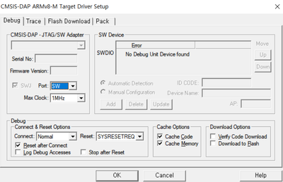

I would like to work on LPC55S14 MCU using LPC-Link2 in keil5.
However, Keil5 says that they can't find LPC-link2.
To address this issue, I downloaded LPCScrypt and ran "Program LPC-Link2 with CMSIS-DAP_2.1.3_83" and updated LPCK-LINK2.
After the update, LPC-link2 will be displayed as "LPC-LINK2 UCom Port (COM15)" in Device Manager as shown above.
But I still can't find LPC-Link2 on Keil5.
What are the options to solve this problem?

Hello @just_lee
Thank you for contacting us.
Please update the CMSIS-DAP firmware of your LPC-Link2 to the J-Link firmware, then check if it can be recognized by KEIL.

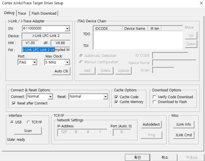

As you said, I updated LPC-Link2 to J-Link using "Program LPC-Link2 with Segger J-Link_2.1.3_83".
After that, when I checked from Keil5 to JLink, it seems to have been recognized as follows.
But the MCU I'm using is a SWD environment, so I want to use "CMSIS-DAP", is there a solution?

Hello @just_lee
How about change JTAG to SWD:
