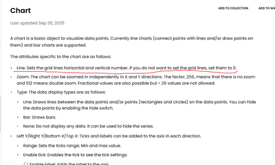

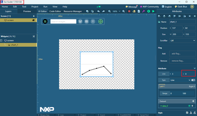

In the chart component of Guiguider, I want to eliminate vertical lines by setting them to 0, but the minimum can only be set to 2. And your guiguider documentation states support for setting to 0, is this a software bug in guiguider?

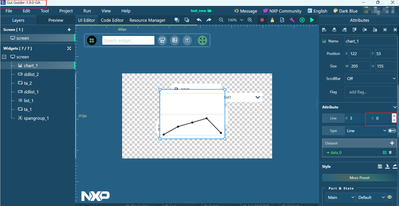

May i ask which GUI GUIDER IDE version you are using?
In GUI GUIDER-1.9.0, It can be set to 0.

MC_xiong_ge
1.10.0

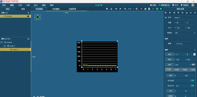

MC_xiong_ge
I tried again, and this bug does indeed appear in the lvgl8 project of GUI Guide 1.10.0. You can try it under the same conditions as me, or use my project directly

Hi @MC_xiong_ge
Thanks for your information.
I can reproduce the issue you mentioned.
