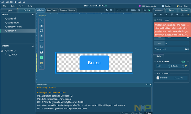

Widget's name should be unique only in the SAME screen, right?
But the IDE was not allow to have widgets with same name in DIFFERENT screen.
And if I copy a screen, the widgets name inside the cloned screen can be kept consistent.
It will be better to allow same name widget across screen for shorter object name in c codes

Hi zzz4web
This is a known issue. It will be fixed in next release GUIGuider_GA_v1.6.0.
Thanks for bringing the problem to our attention.
